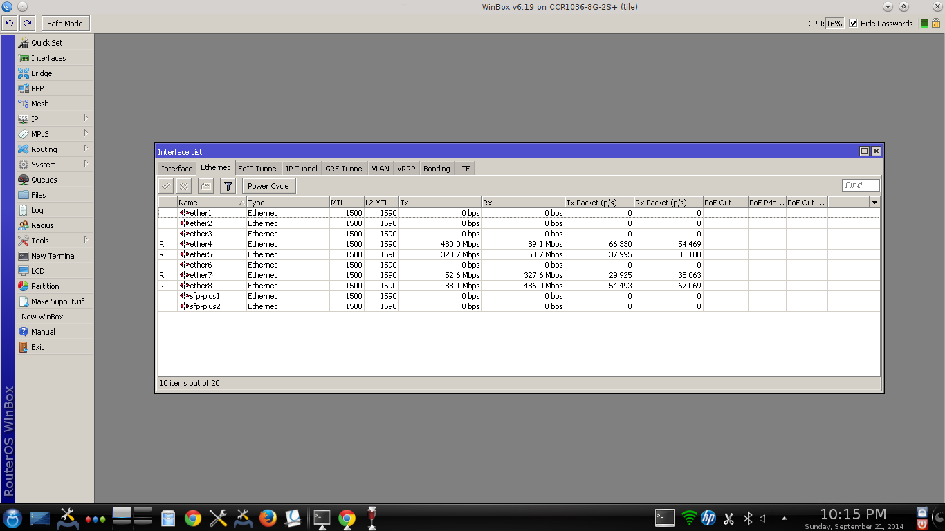

Mine is having 200k pps and 950mbps, cpu usage reaching peak 24%. Screenshots below

Lets see wht changes it does to cpu usage. I’d started graphing the cpu usage.
No noticeable change
peak cpu usage 24%
