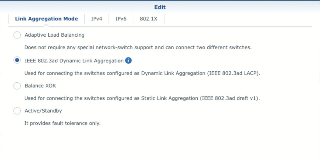

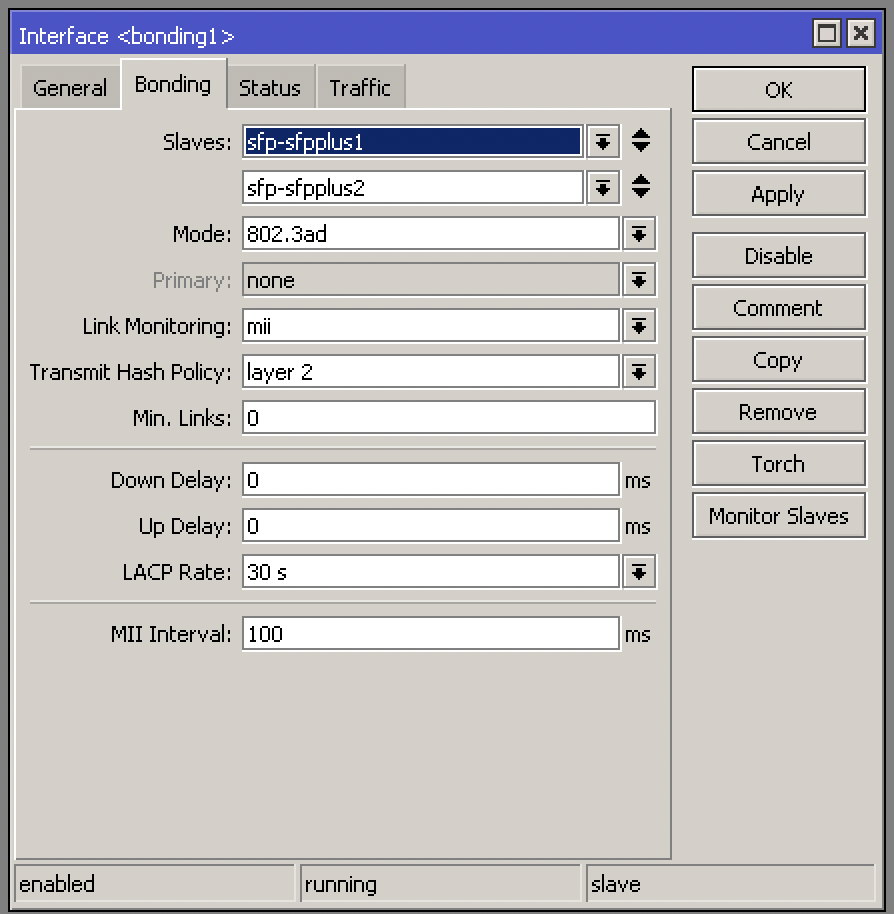

I have created a bonding (bonding1) between SFP+1 and SFP+2 on a mikrotik CCR1036-8G-2S+. The bonding is 802.3ad with mii (link monitoring) and layer 2 transmit hash policy. This bond is connected to two 10Gb ports of a synology NAS RS1619xs+ that also has a bond between those two ports setup as 802.3ad dynamic link aggregation LACP.

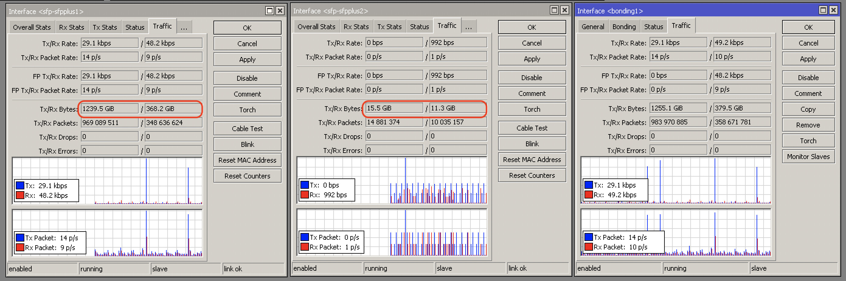

File copies can’t get more than 50MB/s for a 5GB file with iSCSI and SMB3 gets approximately 10MB/s for the same file. Source is copying the file from 1Gb ethernet though. While the transmit-receive rate for the bonding interface on the mikrotik never gets more than 400-500Mbps for this same file.

The SFP+ ports use 100% compatible adapters for the conversion to 10Gb with Cat6 cables. Should I switch to Cat7 instead? Would it make any difference?
Does mikrotik fully support 802.3ad LACP? Should I switch to something else instead?
