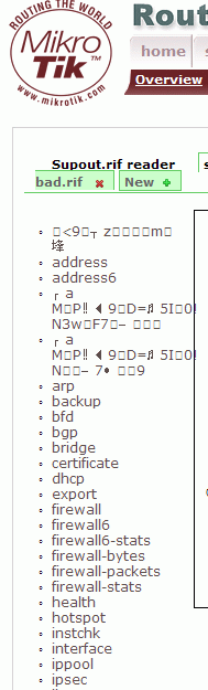

is something going wrong? =)
if that for a specific file? send it to support, we will see what’s so special about it.
All my supouts that I tried show the garbage entries.
Im guessing its the hidden information that MT made the supout viewer not show to us. :slight_smile:
can’t be, show us an example. email support please
I wonder if I can decode these into some useful info :slight_smile:
