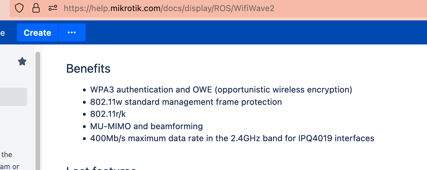

support for 802.11r
I have come across numerous posts and external pages discussing the support for 802.11r, and most of them suggest that it has not been implemented yet. Is this accurate, and if so, why?
I find this confusing since the chip in this router actually supports it.
Thank you for your assistance in advance.
If you go to our documentation:
https://help.mikrotik.com/docs/display/ROS/WifiWave2
