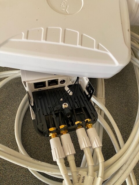

Yeah the LtAP, wAPac, and LtAP mini have some “drill-able” holes to install SMA bulkhead connectors. e.g. the wAPac can mount 4 SMAs on the bottom of the unit. So you can run a “pigtail” cable from the modem module inside to some drilled holes. And, Mikrotik does sell u.FL to SMA pigtails for this purpose. But most newer modem modules use the smaller IPEX4 connectors on the modems, so you may need different pigtails depending on a modem.

I took a photo of a wAPac with 4 pigtails and an external 4x4 antenna. It works, but it requires the pigtails being exposed with ethernet/SIM/power, so it kinda easy to damage and crossing power.
Looks neat though. But yes, such things are almost always a problem with DIY projects (or if device designers did not do their job properly).
