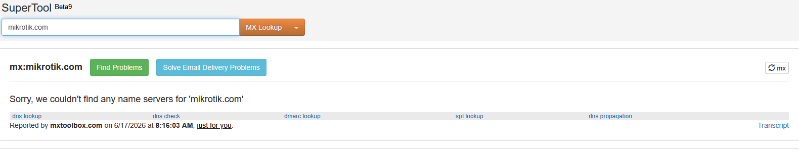

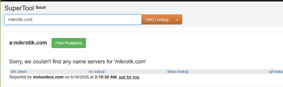

This morning I checked again, and according to mxtoolbox.com, the mikrotik.com domain has no DNS servers, and my emails are still being returned because the domain doesn't exist.
I'm surprised that no one at mikrotik.com has noticed anything or fixed this. It's a serious problem that the MX servers have disappeared, but it's even worse that no one at Mikrotik has detected and fixed it.
It seems like a problem of mxtoolbox. Other services can resolve MX using authoritative dns server without issues.

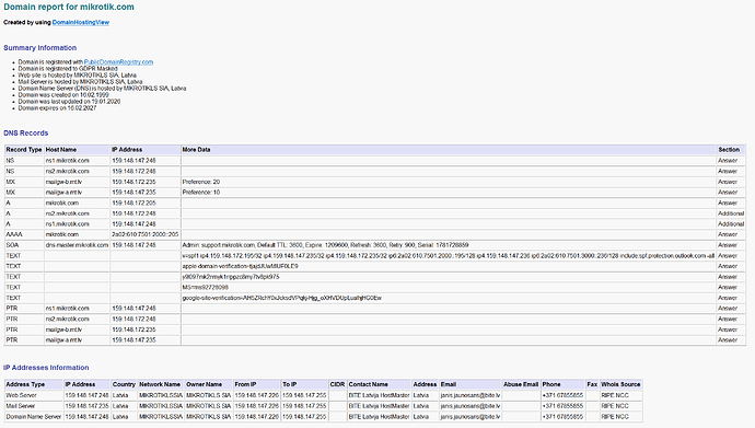

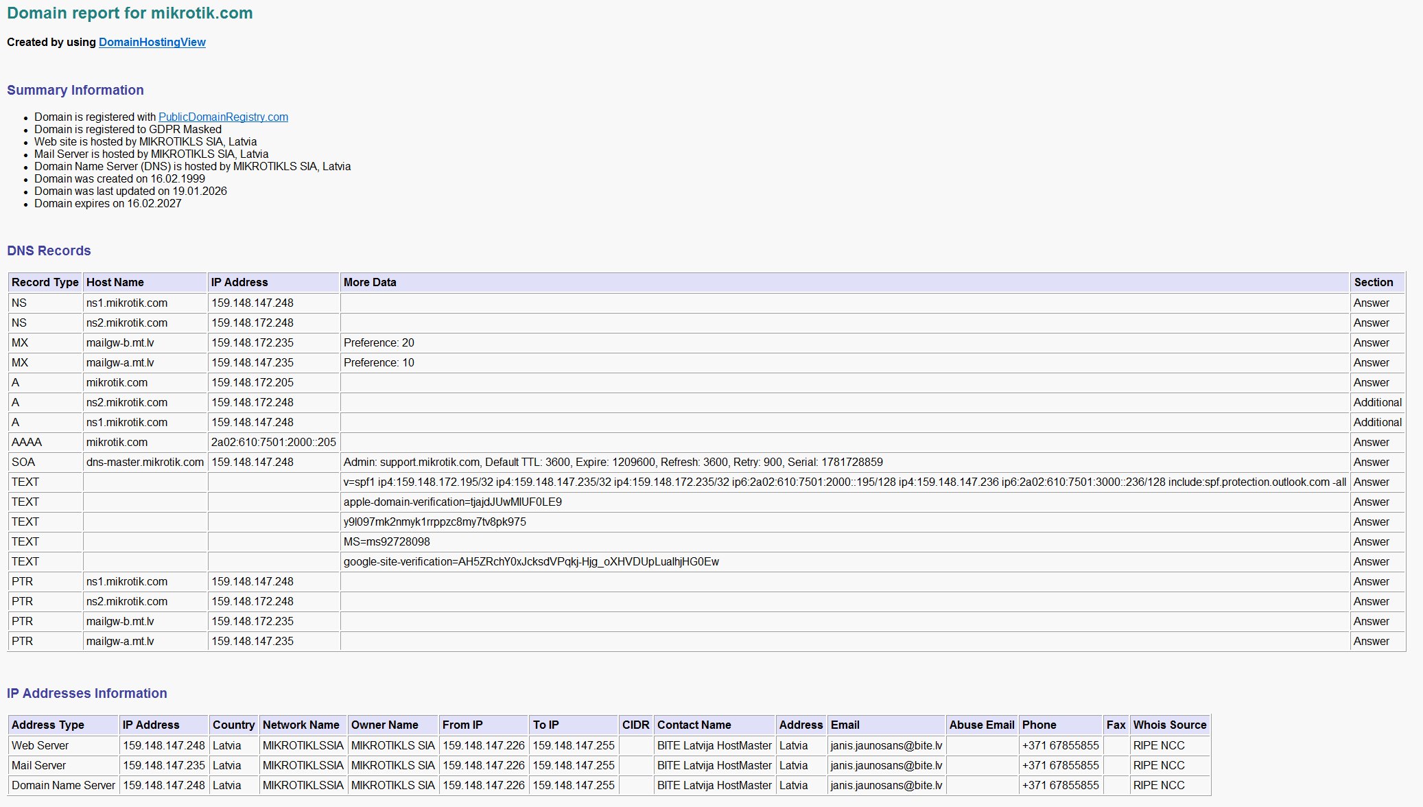

Mikrotik's authoritative DNS server is misconfigured and returning conflicting nameservers vs what is registered at the .com registry.
https://r-1.ch/r1dns/dnscheck.cgi?domain=mikrotik.com
The problem was, Mikrotik's authoritative servers were only responding to Google, Quad9, Cloudflare and some other well known public recursive DNS service.
In addition to that they have conflicting NS records, different from the ones in the WHOIS record.
They fixed the auth DNS server access problem yesterday.
yes it was a short issue on our side, and was fixed yesterday, sorry about the inconvenience
