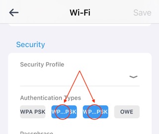

Connect with the MikroTik iOS app to your MikroTik wireless device that supports WPA3 (thus an AX device; an AC2 device would also suit with the wifi-qcom-ac package used).
In the app, go to:
App’s home screen → tap any 2.4 or 5 GHz wireless interface → scroll down to the Security section → in the parameter Authentication Types how the values are displayed:
  • correctly;
  • or the longer ones (WPA2-PSK, WPA3-PSK) are contracted with “…” in the middle (to the point of confusion).
Example of the incorrect:
If possible, please set the iOS setting Display & Brightness –> Display Zoom to "Larger Text” and look in the app again.
Please be kind to answer in the poll, or post a reply here with: Do you see the issue? Do you have the Display Zoom set to "Larger Text”?

MikroTik app update 1.2.16 fixed this bug, from the changelog:
– Adjusted font to prevent truncation of wireless interface configuration’s authentication type options.
