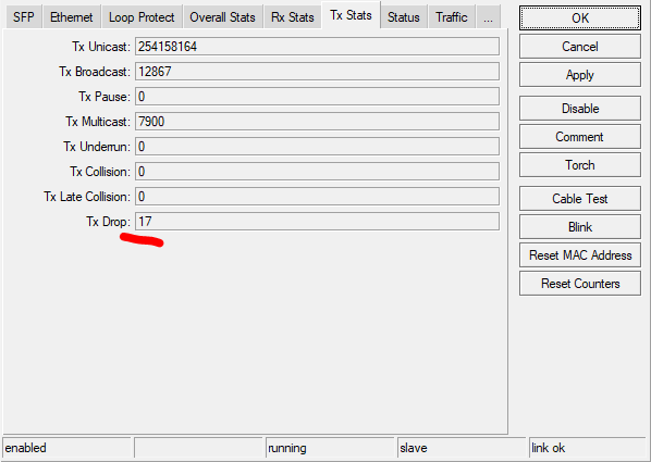

Switch CRS 317 6.49.17 Tx Drop
Boa noite, estou com um problema bem estranho com uma CRS, ela esta taxando erro somente e uma interface " Tx Drop", já foi feito a troca do cordão, Gbic e porta. Porem ela taxa " Tx Drop" sentindo a Borda apenas.Teriam alguma ideia ?.Seria algum problema na CRS ?
Good evening, I have a very strange problem with a CRS, it is only reporting an error and a “Tx Drop” interface, the cord, Gbic and port have already been replaced. However, it only reports “Tx Drop” when sensing the Edge. Do you have any ideas? Could it be a problem with the CRS?

consider upgrading to routeros 7.16.2, then you can enable qos hw offload and obtain detailed drop stats, then if needed you can tune switch buffers to prevent drops
dont forget to do backup and export your settings to your PC before upgrading
also after upgrading RouterOS dont forget to upgrade routerboot to current version (system routerboard upgrade)
after upgrading Switch-qos menu wil be avalilable on winbox
Good evening, could you send me a link to a tutorial teaching how to adjust these buffers, so that I don’t get the “Tx Drop” error. Or would just updating to version 7.16.2 solve the problem?
But send me the link with the tutorial because if, after the update, there is a “Tx Drop” charge, I can do it by following the tutorial.
Today the network consumes 4 to 5 Gbps in media, if possible, tell me what the configuration would look like to enable QOS hardware offloading and adjust the buffers.

Good afternoon, read the documentation, but I don’t understand what will apply here in my case, the CRS 317, could you explain the commands I will use?
