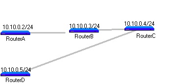

Im using bridged network and when i try to use switch chip real traffic became slow. for example
RouterA Bridged to Router B and RouterB bridged to RouterC. and I use switch on RouterC to connect RouterD. when i try bandwithtest betwen routerC and RouterD everything ok. But When i sent traffic from RouterA Or RouterB to RouterD traffic slow down from 100Mb to 70Mb. and i remove switch chip future than create bridge on RouterC traffic became normal. what can it be ?
