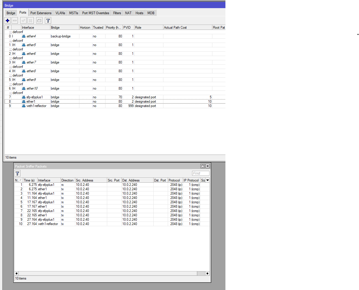

I figured I would turn here in hopes somebody smarter than I can assist with my headache. I have a switch that is on 10.0.2.240/24 (VLAN2) and a router that houses the VLAN on 10.0.2.1/24. I have two connections (SFP+ 10G and 1G Ethernet) that I would like to utilize for fail over. My router is the root RSTP bridge at priority 1000 and the switch is at 3000. As far as I can tell STP isn’t related but not entirely sure. The priority and root cost is lower for the SFP+ on both devices (I want it to prioritize the 10G connection).
So the strange part of this is that I get significant packet loss on ONLY the switch IP address (dropped pings, SSH won’t work etc.) when either:
A: HW offload is disabled on my SFP+ port on the switch (HW offload is already disabled on the router side because I believe that it cannot use HW offload)
B: The bridge port is disabled for ether1 on the router.
All other packets work perfectly fine. I have 5 or so VLANs, they all function, and all traffic on the 10.0.2.0/24 subnet work fine except for the one address (10.0.2.240).
Other VLANs have the same issue when trying to ping / access the switch IP as well. I used the packet sniffer and noticed that HW offloading is disabled or the ether1 is disabled, the router does not get any of the traffic for the IP addresses on the same subnet (as it should be). But when either of those is turned on, the router starts getting a portion of the traffic and that is where it seems my packet loss is.
Hopefully somebody has seen this before and knows if the behavior is a bug or something related to hardware? I am not sure why only this one address would be having this issue. I will try to include some configuration but feel free to let me know if there are any other sections that are needed:
Please, post config export from both devices … run /interface export on both devices for start. It’s much more readable than output of “print detail” for one thing.
And why would you want to disable HW offload on switch? If you do, then all traffic via switch will have to pass CPU and your switch’ CPU is too weak to deal with traffic in any decently performant way. Router is another thing, there SFP port is connected directly to CPU, but router also has quite a bit faster CPU.
Thanks for the response and sorry for the confusion. I very much want HW offloading, without it on the SFP+ on my switch it can’t even handle 1G of throughput. I was just saying that disabling HW offloading or disabling the redundant connection are the only two things that seems to fix the packet loss issue. Here are the interface exports:
Router:
# 2024-10-30 09:24:01 by RouterOS 7.16.1
# software id = 5ZG1-731G
# model = RB4011iGS+
# serial number = XXX
add name=backup-bridge
add admin-mac= auto-mac=no comment=defconf name=bridge \
    port-cost-mode=short priority=0x1000 vlan-filtering=yes
set [ find default-name=sfp-sfpplus1 ] l2mtu=1592
/interface veth
add address=127.1.0.10/32 gateway=127.1.0.1 gateway6="" name=veth1-reflector
/interface wireguard
add listen-port= mtu=1420 name=wireguard1
/interface vlan
add comment="" interface=bridge name="VLAN 2" vlan-id=2
add comment="" interface=bridge name="VLAN 5" vlan-id=5
add comment="" interface=bridge name="VLAN 10" vlan-id=10
add comment="" interface=bridge name="VLAN 20" vlan-id=20
add comment="" interface=bridge name="VLAN 25" vlan-id=25
add comment="" interface=bridge name="VLAN 30" vlan-id=30
add comment="" interface=bridge name="VLAN 250" vlan-id=250
add comment=defconf name=WAN
add comment=defconf name=LAN
add name=VLAN
add bridge=backup-bridge comment=defconf interface=ether4 internal-path-cost=\
    10 path-cost=10
add bridge=bridge comment=defconf interface=ether5 internal-path-cost=10 \
    path-cost=10
add bridge=bridge comment=defconf interface=ether6 internal-path-cost=10 \
    path-cost=10
add bridge=bridge comment=defconf interface=ether7 internal-path-cost=10 \
    path-cost=10
add bridge=bridge comment=defconf interface=ether8 internal-path-cost=10 \
    path-cost=10
add bridge=bridge comment=defconf interface=ether9 internal-path-cost=10 \
    path-cost=10
add bridge=bridge comment=defconf interface=ether10 internal-path-cost=10 \
    path-cost=10
add bridge=bridge comment=defconf interface=sfp-sfpplus1 internal-path-cost=5 \
    path-cost=5 point-to-point=yes priority=0x70 pvid=2
add bridge=bridge disabled=yes interface=ether1 internal-path-cost=10 \
    path-cost=10 point-to-point=yes pvid=2
add bridge=bridge edge=yes frame-types=admit-only-vlan-tagged \
    ingress-filtering=no interface=veth1-reflector learn=yes \
    multicast-router=permanent point-to-point=yes pvid=999
/interface bridge vlan
# ether1 not a bridge port
add bridge=bridge tagged=bridge,ether1,veth1-reflector,sfp-sfpplus1 vlan-ids=\
    2,5,10,20,25,30,250
/interface detect-internet
set detect-interface-list=WAN
add interface=ether1 list=LAN
add interface=ether2 list=WAN
add interface=ether3 list=WAN
add interface=ether4 list=LAN
add interface="VLAN 10" list=VLAN
add interface="VLAN 2" list=VLAN
add interface="VLAN 20" list=VLAN
add interface="VLAN 25" list=VLAN
add interface="VLAN 250" list=VLAN
add interface="VLAN 30" list=VLAN
add interface="VLAN 5" list=VLAN
add interface=backup-bridge list=LAN
add interface=sfp-sfpplus1 list=LAN
add interface=wireguard1 list=VLAN
Switch:
# oct/30/2024 09:29:48 by RouterOS 6.49.17
# software id = GANV-3F2U
# model = CRS328-24P-4S+
add name=backup-bridge protocol-mode=none
add admin-mac= auto-mac=no comment=defconf \
    ingress-filtering=yes name=bridge priority=0x3000 vlan-filtering=yes
set [ find default-name=ether1 ] comment=""
set [ find default-name=ether2 ] comment=""
set [ find default-name=ether3 ] comment=""
set [ find default-name=ether4 ] comment="t"
set [ find default-name=ether5 ] comment=""
set [ find default-name=ether6 ] comment=""
set [ find default-name=ether7 ] comment=""
set [ find default-name=ether8 ] comment=""
set [ find default-name=ether9 ] comment=""
set [ find default-name=ether10 ] comment=""
set [ find default-name=ether11 ] comment=""
set [ find default-name=ether12 ] comment=""
set [ find default-name=ether13 ] comment="" disabled=yes
set [ find default-name=ether14 ] comment=""
set [ find default-name=ether15 ] comment=""
set [ find default-name=ether16 ] comment=""
set [ find default-name=ether19 ] comment=""
set [ find default-name=ether20 ] comment=""
set [ find default-name=ether21 ] comment=""
set [ find default-name=ether23 ] comment=""
set [ find default-name=ether24 ] comment=""
set [ find default-name=sfp-sfpplus1 ] advertise="10M-half,10M-full,100M-half,\
    100M-full,1000M-half,1000M-full,2500M-full,5000M-full,10000M-full" \
    comment="Uplink to Router"
set [ find default-name=sfp-sfpplus2 ] advertise="10M-half,10M-full,100M-half,\
    comment="QNAP Top"
set [ find default-name=sfp-sfpplus3 ] advertise="10M-half,10M-full,100M-half,\
set [ find default-name=sfp-sfpplus4 ] advertise="10M-half,10M-full,100M-half,\
    comment="QNAP Bottom"
/interface vlan
add interface=bridge name="VLAN 2" vlan-id=2
/interface bonding
add mode=802.3ad name=QNAP slaves=sfp-sfpplus2,sfp-sfpplus4
add name=VLAN
add name=Uplink
add bridge=bridge comment=defconf ingress-filtering=yes interface=ether2 \
    pvid=5
add bridge=bridge comment=defconf ingress-filtering=yes interface=ether3 \
    pvid=5
add bridge=bridge comment=defconf ingress-filtering=yes interface=ether4 \
    pvid=5
add bridge=bridge comment=defconf ingress-filtering=yes interface=ether5 \
    pvid=5
add bridge=bridge comment=defconf ingress-filtering=yes interface=ether6 \
    pvid=5
add bridge=bridge comment=defconf ingress-filtering=yes interface=ether7 \
    pvid=5
add bridge=bridge comment=defconf ingress-filtering=yes interface=ether8 \
    pvid=5
add bridge=bridge comment=defconf ingress-filtering=yes interface=ether9 \
    pvid=2
add bridge=bridge comment=defconf ingress-filtering=yes interface=ether10 \
    pvid=5
add bridge=bridge comment=defconf ingress-filtering=yes interface=ether11 \
    pvid=2
add bridge=bridge comment=defconf ingress-filtering=yes interface=ether12 \
    pvid=2
add bridge=bridge comment=defconf ingress-filtering=yes interface=ether13 \
    pvid=250
add bridge=bridge comment=defconf ingress-filtering=yes interface=ether14 \
    pvid=250
add bridge=bridge comment=defconf ingress-filtering=yes interface=ether15 \
    pvid=2
add bridge=bridge comment=defconf ingress-filtering=yes interface=ether16 \
    pvid=250
add bridge=backup-bridge comment=defconf ingress-filtering=yes interface=\
    ether17
add bridge=bridge comment=defconf ingress-filtering=yes interface=ether18 \
    pvid=2
add bridge=bridge comment=defconf ingress-filtering=yes interface=ether19
add bridge=bridge comment=defconf ingress-filtering=yes interface=ether20 \
    pvid=2
add bridge=bridge comment=defconf ingress-filtering=yes interface=ether21 \
    pvid=2
add bridge=bridge comment=defconf ingress-filtering=yes interface=ether22 \
    pvid=2
add bridge=bridge comment=defconf ingress-filtering=yes interface=ether23 \
    pvid=2
add bridge=bridge comment=defconf ingress-filtering=yes interface=ether24 \
    pvid=2
add bridge=bridge comment=defconf ingress-filtering=yes interface=\
    sfp-sfpplus3
add bridge=bridge comment=QNAP ingress-filtering=yes interface=QNAP pvid=2
add bridge=bridge disabled=yes ingress-filtering=yes interface=ether1 \
    internal-path-cost=15 path-cost=15 point-to-point=yes pvid=2
add bridge=bridge ingress-filtering=yes interface=sfp-sfpplus1 \
    internal-path-cost=5 path-cost=5 point-to-point=yes priority=0x70 pvid=2
add bridge=bridge tagged="bridge,ether18,ether11,ether23,ether22,ether20,ether\
    24,ether21,ether15,ether1,sfp-sfpplus1" untagged=\
    ether16,ether12,ether9,QNAP vlan-ids=2
add bridge=bridge tagged="ether23,ether24,ether22,ether20,ether11,bridge,ether\
    21,ether15,QNAP,ether1,sfp-sfpplus1" untagged=\
    ether7,ether8,ether10,ether2,ether3,ether4,ether5,ether6 vlan-ids=5
add bridge=bridge tagged="QNAP,ether18,ether11,ether23,ether15,ether2,ether3,e\
    ther4,ether6,ether20,ether22,ether24,bridge,ether21,ether1,sfp-sfpplus1" \
    vlan-ids=25
add bridge=bridge tagged="QNAP,ether18,ether11,ether23,ether24,ether2,ether3,e\
    ther4,ether6,ether22,ether20,bridge,ether21,ether15,ether1,sfp-sfpplus1" \
    untagged=ether13,ether14,ether16 vlan-ids=250
add bridge=bridge untagged=bridge vlan-ids=1
add bridge=bridge tagged="ether18,ether11,ether23,bridge,QNAP,ether15,ether20,\
    ether21,ether24,ether1,sfp-sfpplus1" vlan-ids=20
add bridge=bridge tagged=QNAP,ether1,bridge,sfp-sfpplus1 vlan-ids=30
add bridge=bridge disabled=yes tagged=QNAP,ether1,sfp-sfpplus1,bridge \
    vlan-ids=10
set detect-interface-list=Uplink
add interface=sfp-sfpplus1 list=Uplink
add interface=ether1 list=Uplink
I suggest you to upgrade ROS to latest v7 (7.16.1 at this time) on CRS. There were some changes in how RSTP works after 7.13.
Also I wouldn’t bother with setting port properties, bridge priority setting should do just fine. Port cost is inversely proportional to port speed, even without manually setting port property the 10Gbps SFP+ will be preferred link between both bridges.
Another thing: set sensible value to admin-mac property or unset it altogether. Settibg it to empty value may be causing problems.
Hi cpeshalelimpix,
Here’s another suggestion: try disabling the “detect internet” feature on the switch, or even better, on both devices.
Thanks for replying guys, it does indeed appear to be the detect internet on the switch that was causing the flapping / packet loss.
Thanks so much for your guy’s help!
