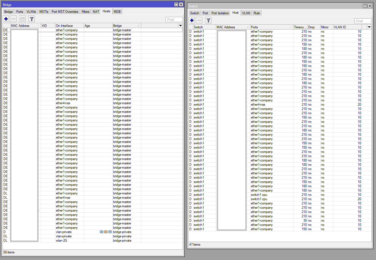

And screenshots, beta54:

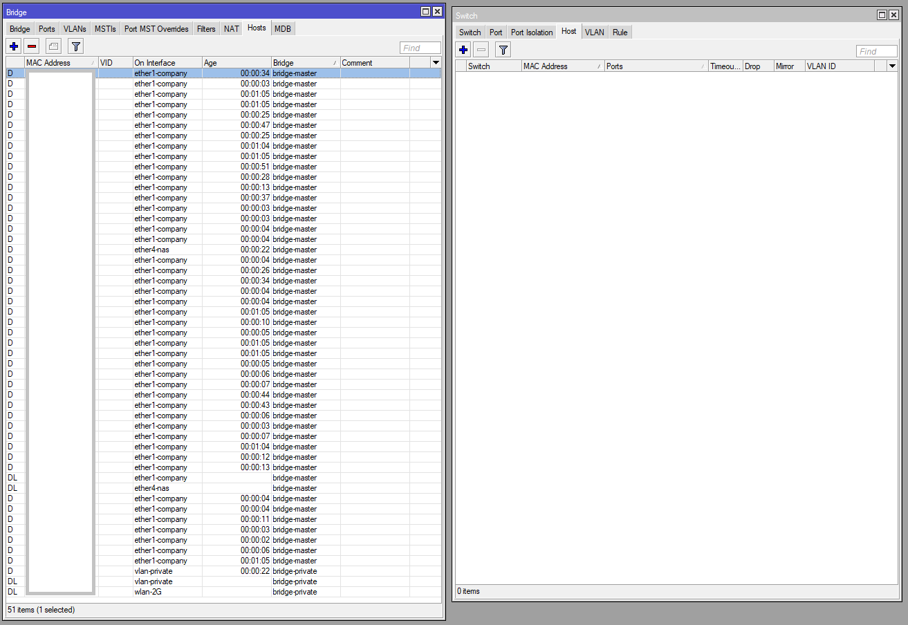

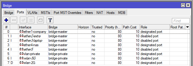

After upgrading to beta62:
HW offload is gone on all ports, no MAC adresses learned in switch. In-switch VLANs are not working.
