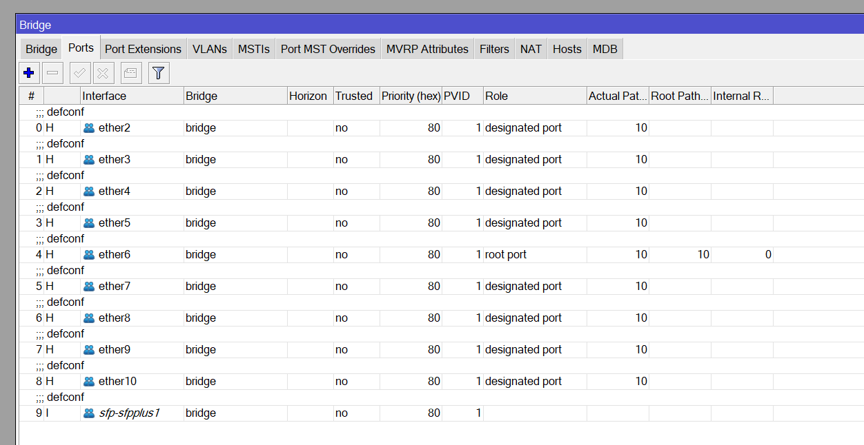

In the attached image the port appears as “root”, it is the ether6, in case it contributes something.

The IP assignment is done through reservation (static lease). Hence the misinterpretation. On what port is the switch connected to the RB4011?
Port 6, MK says it is a “root” port.
