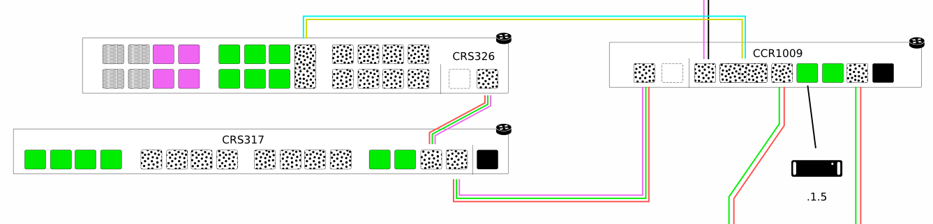

I’m quite new to Layer 2 (unfortunately i started from top of OSI and stepped down successively) so I decided to get some grip here. In order to test various more advanced configs I decided to create something like this:
ports with dots represent tagged ports, colors represent untagged ports. coloured lines represent vlans carrying networks to corresponding ports. When I created config with single trunk (so that all VLANs go through CRS317), everything worked. However when I added LACP group and moved 2 VLANs to this second trunk it didn’t quite work. It sometimes worked, sometimes didn’t. Switch really didn’t like this config and expressed it by really non deterministic behavior. Sometimes everything worked fine but after reboot nothing worked again. It’s not problem with LACP itself because when I disabled bottom trunk it was deterministic again.
I think there’s some nasty loop happening here but I don’t know why. I enabled VLAN filtering on bridges on both switches and VLANs supported by trunks did not overlap. I also set frames-type to “allow-only-vlan-tagged” on trunks to avoid accidental default vlan loop. Both switches have protocol-mode set to none because mstp was cutting out CRS317 from router. I’m not sure how to enable mstp for router.
Where’s my mistake?

Config with 2 trunks is exactly the same except this part:

And this one doesn’t work. Inb4 I’m using one vlan per port because I want to have stateful firewall between each device inside single network so I’m using CCR1009 to bridge VLANs with bridge ip firewall enabled (I’m essentially using CCR1009 as firewall in this case). So all 40x vlans are in one bridge, all 30x in another etc. Those are separate bridges on CCR. VLAN interfaces are assigned directly to physical interfaces and then those VLAN interfaces are put in appropriate bridges. Like this:

EDIT:
Actually it turns out bonding setup doesn’t work even if there’s no connection between switches and everything works if instead of bonding, single cable is used as second trunk. I’m confused…
It turns out sometimes VLAN interfaces on CCR1009 randomly don’t get up and require disabling and reenabling… ._.
