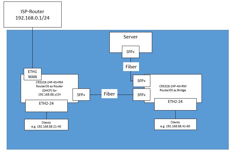

My use case would be mainly a LAN, with a Server and multiple CRS-Switches/Routers. With 1 Line connected to the Internet:
If the server pushes data out via Fiber, assuming 5 Gbps and needs to serve several clients simultaneous (let’s assume 150 Mbps / client), theoretically i could serve 33 clients (150x33=4.9Gbps) correct? Now my question is (related to the Test results), which of the shown figures are relevant in this case- is that Switching / Bridging / Routing? Or does it depend on how i operate the CRS (in SwOS or RouterOS?)

Hi @mkx,
thank you for your feedback & explanation.
Just to make sure I understood you correct as well as applied to my use-case:
  • Switching: Moving Ethernet Frames from one Interface to another, within the same IP subnet.
  • Bridging: N/A in my case (no VLANs needed / active)
  • Routing: IP packages moving between different IP networks (+NAT / Firewall)
I am just confused with this statement:
In your case that’s traffic between left and right LAN segments and traffic between both LANs and internet.
For me the “blue” network is all within the same IP Subnet (192.168.88.xxx), so in my understanding (feel free to correct me) all traffic in there is “just” switched. Meaning, Data coming from the server, goes to the Switch(right) goes to the other Switch (left) and to a client connected there.
Routing in my understanding would be, if a client connected to either Switch (left or right), requests data from the ISP-Router (outside of the 192.168.88.xxx LAN). In this case the Switch on the left would need to route the traffic “outside”?
Or am I mixing this up, and any link between the left and the right Switch requires routing, even in the same IP subnet? :confused:
You’re absolutely right, I’ve looked at the chart without due dilligence. So in your case, routing would only happen between LAN and internet. So CRS might do as router as well depending on WAN link speed.
Great, thanks for the confirmation.
So basically, for the “blue” network I should be able to assume a rough max. throughput rate of 48Gbps (non-blocking Layer 2 throughput @ 64byte) for switching between the 2 switches. (Going back to my initially mentioned example, handling 33 clients with 5 Gbps should not be a problem?)
And as a connection to the outside world, without any additional restrictions for routing: 175Mbps as max routing capacity.
Is there any specific setting in RouterOS, that I would need to configure so that the Switches are set to “switching”, meaning trying to push their throughput up, or is that handled automatically depending the Input / output IP-range?
In ROS you first configure L2 stuff … e.g. you create a bridge with selected interfaces as its members. “bridge” then offloads as much operations to the switching hardware and in your case that’s just about everything related to intra-LAN traffic.
On the “routing” CRS you’ll leave out one ether interface ftom the bridge and you’ll use that port for WAN. Traffic will be handled by CPU.
Just a side note: one use case would be to partition switch to two independent halves. It this case the straight-forward approach would be to create two bridges and assign ether interfaces to one or the other. However, there’s limitation that only single bridge can offload tasks to switching hardware. So one half of switch would be “bridging” with its speed limits.
The work around is to use single bridge with two VLANs, assigning ether ports as access ports to one or another VLAN. This setup is fully offloaded to switching hardware.
