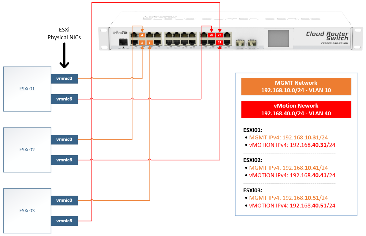

CURRENT TOPOLOGY:

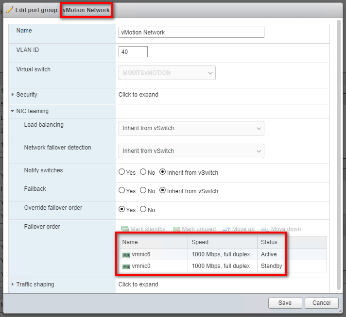

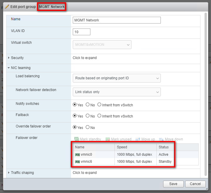

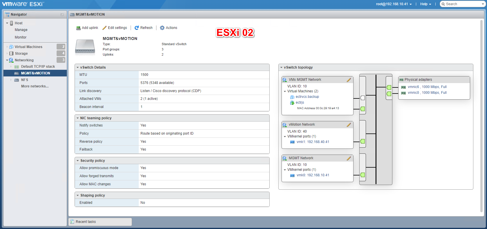

  • However for a correct configuration on the ESXi servers side, I have used 2 NICs for failover (see configuration below for the second ESXi but the other ones are exactly the same):
  • Uplink vmnic0 for MGMT traffic (on VLAN 10)
  • Uplink vmnic6 for vMotion traffic (on VLAN 40)
  • The problem is that the failover does not work. If I power off - for instance - ether3 on the router, the NIC for vMotion must take over also for the MGMT traffic on the ESXi 01 but that’s not happening

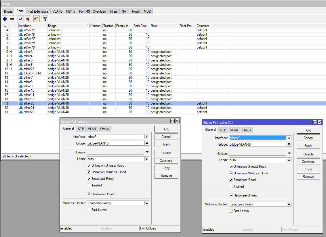

  • Please find below some screenshots explaining the way I configured my MikroTik router:
  • It seems like configuring the very same port to accept tagged packets from two (or more) different VLANs doesn’t work (at least for me).

I understand this is not possible with VMware, but post the text export of the CRS configuration - see the mini-howto in my automatic signature just below.
The basic mode of Ethernet redundancy on VMware doesn’t use port-channel or LACP but simply uses one physical NIC systematically for one group of MAC addresses and the other one for another group of MAC addresses, and it only changes this mapping if one of the NICs goes down.
Also, you use the “old” way of configuring VLANs on Mikrotik (one bridge per VLAN), which effectively means the CRS forwards all VLANs but one in software, and it’s CPU is by far not sufficient for wirespeed forwarding. This has nothing to do with your issue, though.

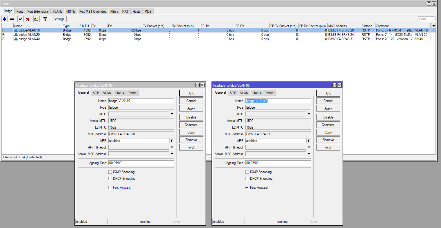

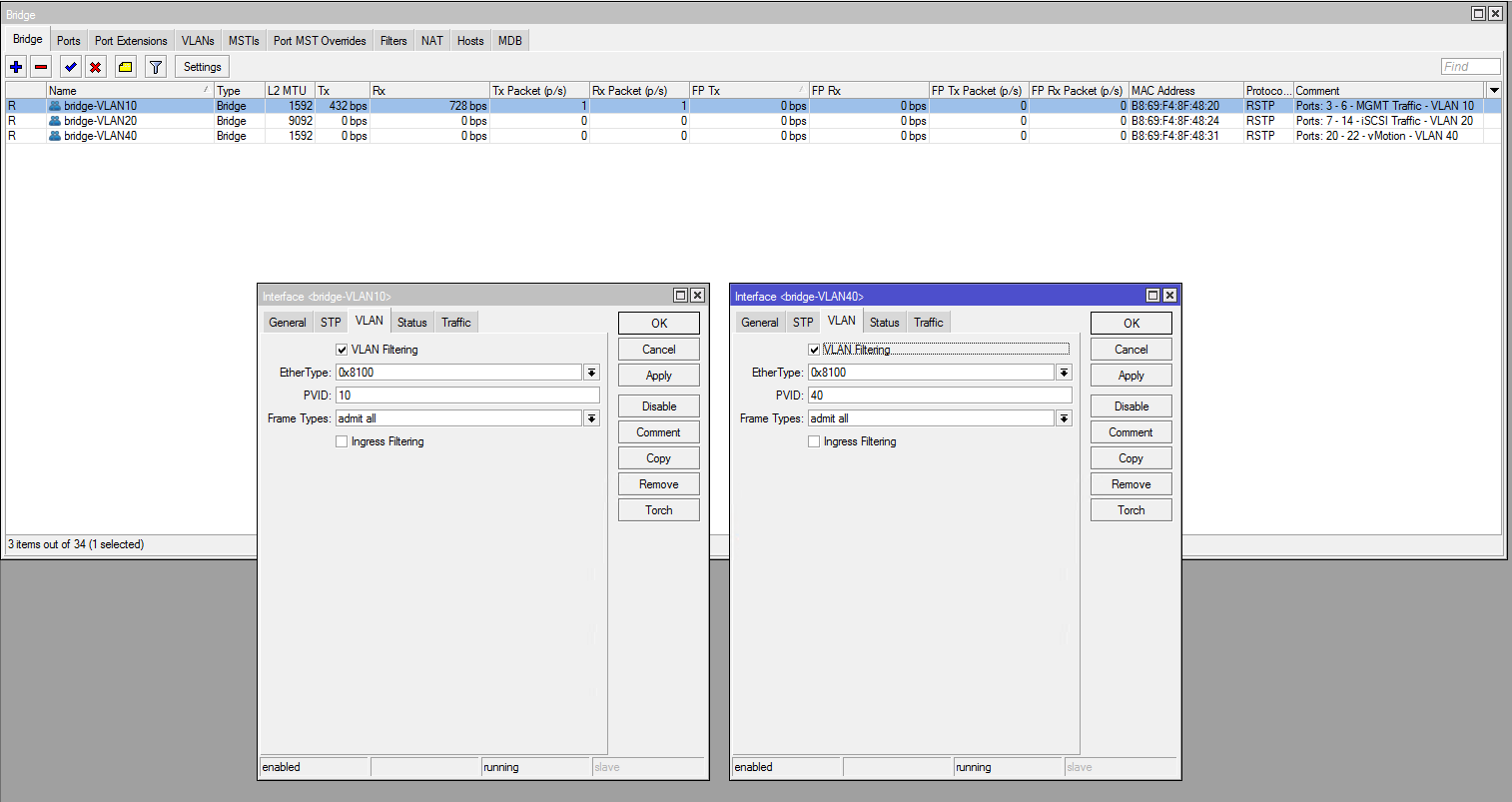

add comment="Ports: 3 - 6 - MGMT Traffic - VLAN 10" name=bridge-VLAN10 pvid=\
    10 vlan-filtering=yes
add comment="Ports: 7 - 14 - iSCSI Traffic - VLAN 20" name=bridge-VLAN20 \
    pvid=20 vlan-filtering=yes
add comment="Ports: 20 - 22 - vMotion - VLAN 40" name=bridge-VLAN40 pvid=40 \
    vlan-filtering=yes

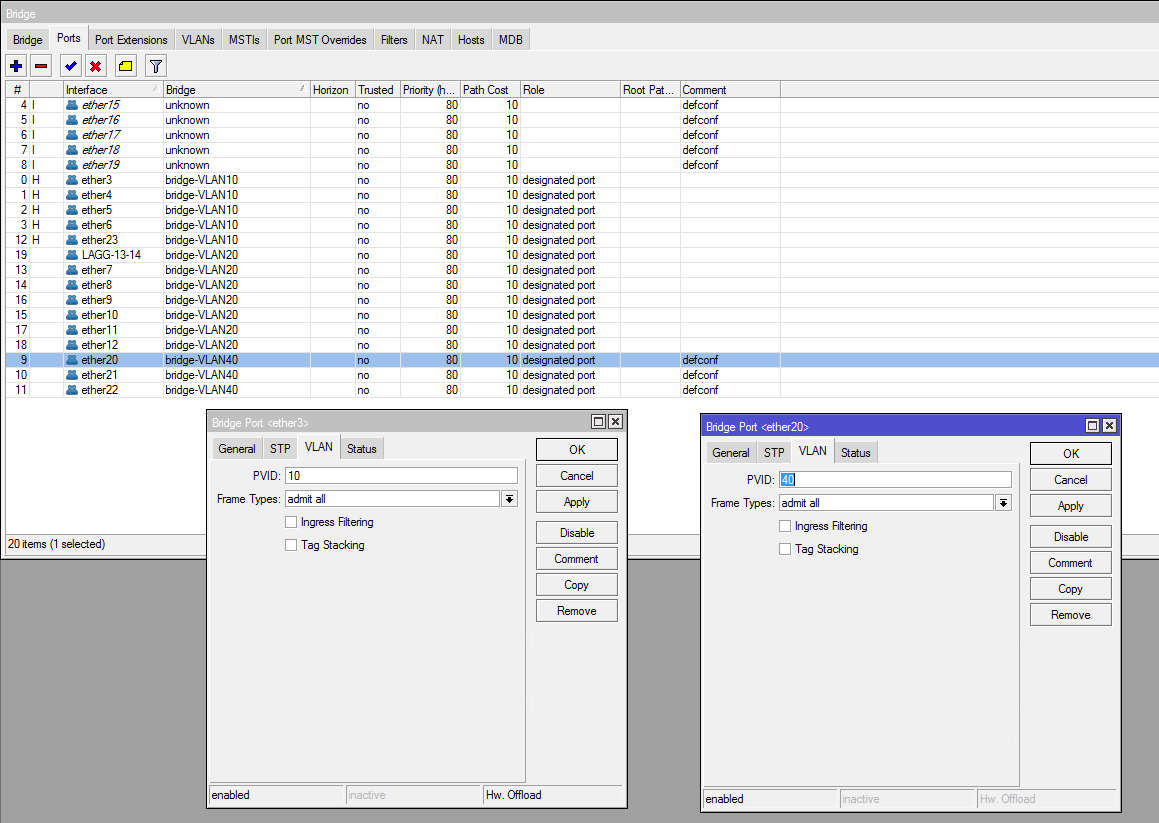

add bridge=bridge-VLAN10 interface=ether3 pvid=10
add bridge=bridge-VLAN10 interface=ether4 pvid=10
add bridge=bridge-VLAN10 interface=ether5 pvid=10
add bridge=bridge-VLAN10 interface=ether6 pvid=10
add comment=defconf interface=ether15
add comment=defconf interface=ether16
add comment=defconf interface=ether17
add comment=defconf interface=ether18
add comment=defconf interface=ether19
add bridge=bridge-VLAN40 comment=defconf interface=ether20 pvid=40
add bridge=bridge-VLAN40 comment=defconf interface=ether21 pvid=40
add bridge=bridge-VLAN40 comment=defconf interface=ether22 pvid=40
add bridge=bridge-VLAN10 interface=ether23 pvid=10
add bridge=bridge-VLAN20 interface=ether7 pvid=20
add bridge=bridge-VLAN20 interface=ether8 pvid=20
add bridge=bridge-VLAN20 interface=ether10 pvid=20
add bridge=bridge-VLAN20 interface=ether9 pvid=20
add bridge=bridge-VLAN20 interface=ether11 pvid=20
add bridge=bridge-VLAN20 interface=ether12 pvid=20
add bridge=bridge-VLAN20 interface=LAGG-13-14 pvid=20

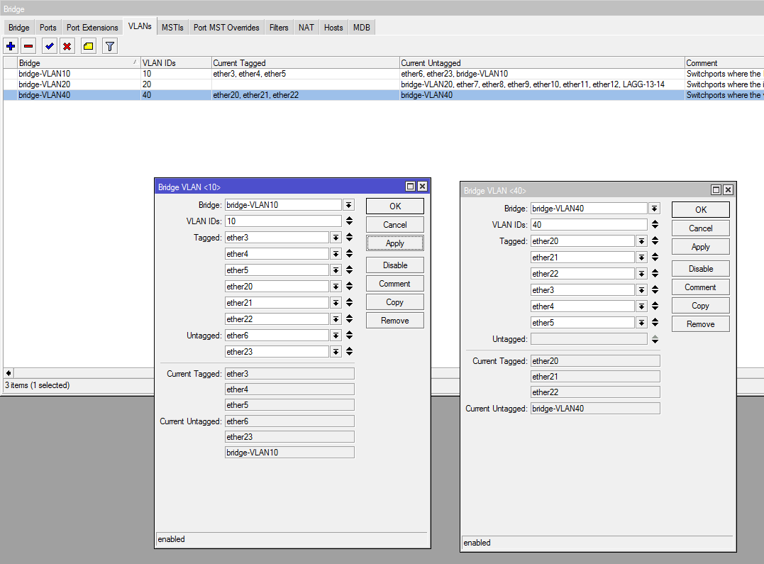

/interface bridge vlan
add bridge=bridge-VLAN20 comment="Switchports where the iSCSI ports of all ESX\
    i servers and the iSCSI ports of the datastore are hooked are tagged as th\
    ey are in the same VLAN but packets are coming tagged from them" \
    untagged=ether7,ether8,ether9,ether10,ether11,ether12,ether13,ether14 \
    vlan-ids=20
add bridge=bridge-VLAN40 comment="Switchports where the vMotion port of all ES\
    Xi servers are hooked are tagged as packets coming from them are tagged an\
    d - of course - they are WITHIN the same VLAN" tagged=\
    ether20,ether21,ether22,ether3,ether4,ether5 vlan-ids=40
add bridge=bridge-VLAN10 comment="Switchports where the MGMT port of the ESXi \
    servers are hooked are tagged. Switchport where the MGMT port of the datas\
    tore is hooed is untagged. However ALL devices (ESXi servers and datastore\
    ) are WITHIN the same VLAN" tagged=\
    ether3,ether4,ether5,ether20,ether21,ether22 untagged=ether6,ether23 \
    vlan-ids=10

**>>Also, you use the “old” way of configuring VLANs on Mikrotik (one bridge per VLAN), which effectively means the CRS forwards all VLANs but one in software, and it’s CPU is by far not sufficient for wirespeed forwarding. This has nothing to do with your issue, though**I have been “struggling” in finding the best (and most elegant) way to configure VLANs in MikroTik routers like mine but this is only the one I was able to put in place. If you can spare sometime to provide some documentation or point me to a better direction, that would be highly appreciated :slight_smile:
_>>What is the ESXi version? I had issues with NIC redundancy with some older ESXi versions_It’s in the original post: 6.7 U3
Regards.
Ivano
You have done almost everything the correct way for the “all VLANs on a single bridge” approach, but broke it all by doing that on three independent bridges. And I am surprised the configuration doesn’t flash red and beep, because you cannot make a single Ethernet interface a member port of multiple bridges, which is exactly what you’ve done.
So can you confirm that you use 10.26.11.19 to manage the switch, i.e. you won’t lose management access to it no matter what happens to VLANs 10, 20, and 40?
I can give you a script to copy-paste line by line, or interpreted manually using mouse clicks if you prefer, to fix the mess, but I need to know whether some extra steps are required to migrate the management access safely or whether the fix can be done the most straightforward way.
Also please clarify whether the CRS itself needs to have an own IP address in each of these 3 VLANs because it is used as a gateway for other devices in those VLANs/subnets.
Hi Sindy,
Apologies for the late reply. Forgot to reply a while ago (actually the day after you sent me your last post).
After reviewing my configuration, everything is correct and I’m surprised you said it was a mess. I repeat, everything was correctly configured.
The root cause was a bug in VMware which was fixed in vSphere 7.
Thanks for your help btw. You were very helpful and that was highly appreciated.
You can close this topic.
Regards.
~Ivano
Well, my concern was that you use the “one bridge per VLAN” approach, which normally excludes hardware-accelerated bridging - but maybe on CRS, this is not an issue as long as each such bridge uses a distinct set of Ethernet ports. So if you can see the H indicator on all rows of /interface bridge port print, indicating that hardware acceleration is indeed active, it’s OK.
What is against all what the manuals say is that you’ve configured the same Ethernet interfaces to be member ports of two distinct bridges under /interface bridge vlan, but I’d assume that what prevails is the /interface bridge port section, so the interface names in red in the lists are actually ignored.
add bridge=bridge-VLAN40 tagged=**ether3,ether4,ether5,**ether20,ether21,ether22 vlan-ids=40
add bridge=bridge-VLAN10 tagged=ether3,ether4,ether5,ether20,ether21,ether22 untagged=ether6,ether23 vlan-ids=10
This is not a support portal, just a peer forum, so technically I cannot as I am not an admin :slight_smile:
