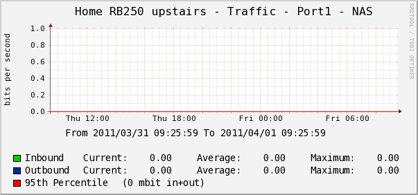

I’ve been trying SwOS out at home before we even think about selling it to our customers… I’m definitely seeing strange SNMP data coming back from SwOS (1.4). Typically:
Data simply not being reported - this is my NAS which typically shifts several GB a day:

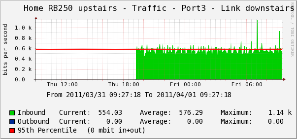

Data being mis-reported - this is the link downstairs to the media PC, a SIP phone, a couple of PCs and the satellite box. Apparently the switch received a little data from them and sent nothing. Again, this link shifts several GB a day:

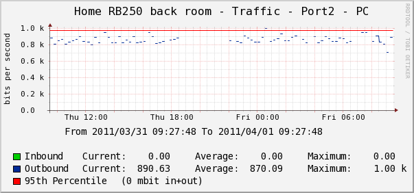

Very strange situations where the OID just disappears (note that the same switch produces continuous data on other ports). This gives gappy graphs. Note that this PC actually shifts more data than the little data in the graph actually indicates:
