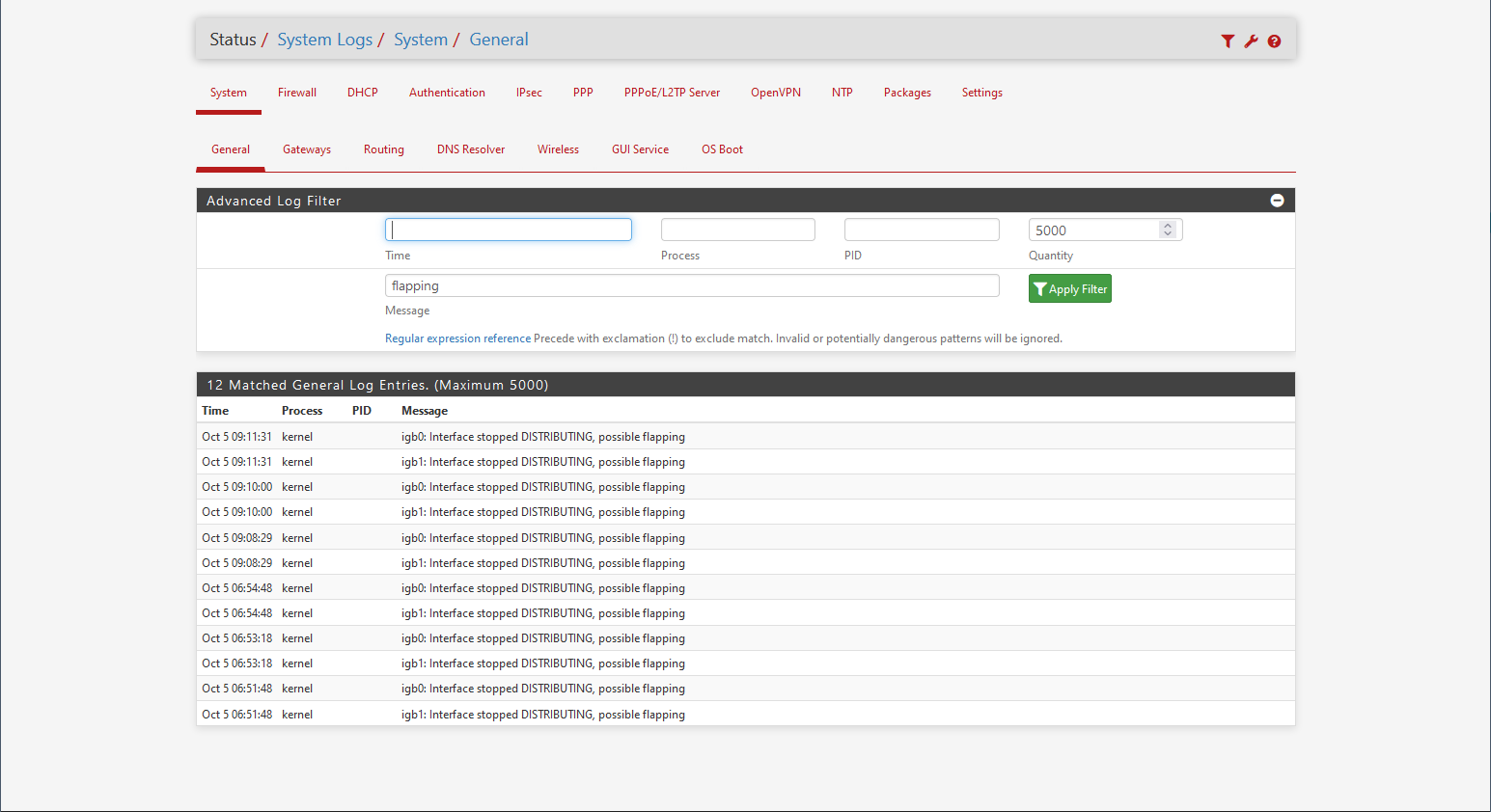

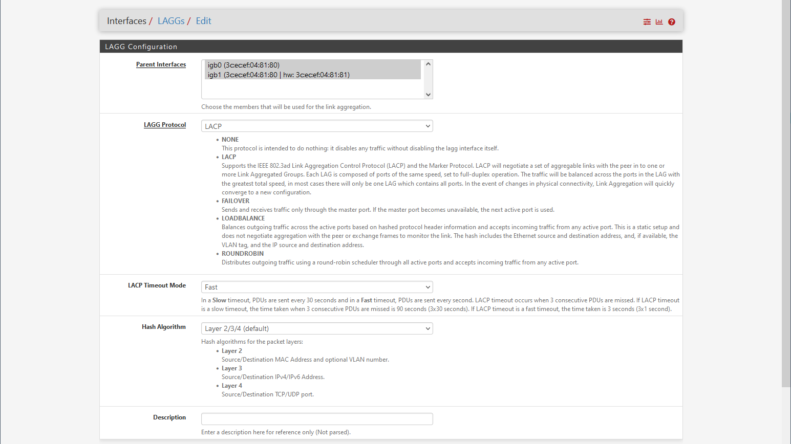

My CSS610 is connected via LACP (active) to a pfSense 2.7 (Fast mode, Layer 2,3,4) on a Supermicro X11SCL-iF board. Since the update I get messages that igb0 and igb1 interfaces are flapping at the same time.

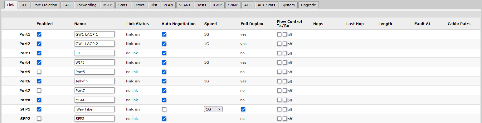

I do not see any errors on the switch in the error tab, but sometimes errors are displayed on the link tab with impossible lengths, which after a tab change and back either don’t appear anymore or appear with different values and states.

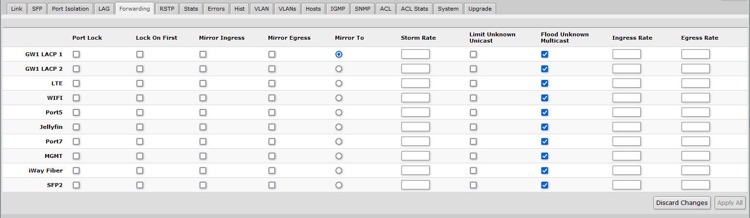

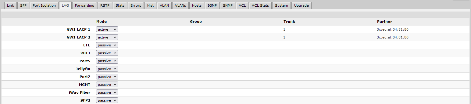

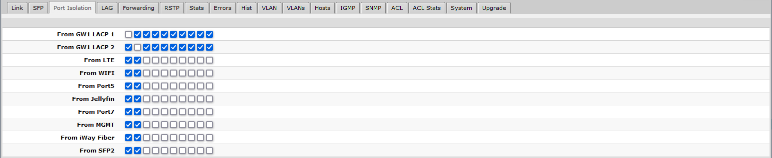

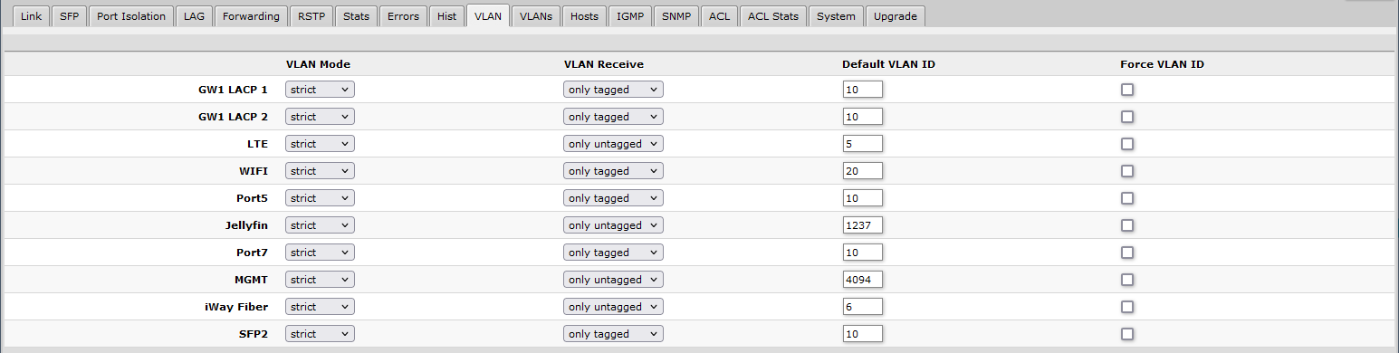

Can you share screenshots of the configuration on the switch and router relevant to this issue?
The screenshots are from the current running version 2.14. I didn’t change anything in the configuration after the update to 2.17.

I find it interesting that your CSS610 seems to recognise the LAG as being one and not two separate ones, despite your pfsense config showing that you use more than L2 hashing.
From https://help.mikrotik.com/docs/display/SWOS/CSS610+series+Manual#CSS610seriesManual-LAG (emphasis by me):
IEEE 802.3ad (LACP) compatible link aggregation is supported, as well as static link aggregation to ensure failover and load balancing > based only on Layer2 hashing.

I have already adjusted the LACP hash algorithm on the pfSense and change mode to passive.
