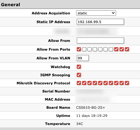

It’s probably a confguration issue, trunks and vlans are working without any issue on this device running 2.14.
For a trunk port see this working example (everything is tagged, even management - not a hybrid port):
VLAN Tab:
VLANs Tab:
System Tab:
Greetings,
