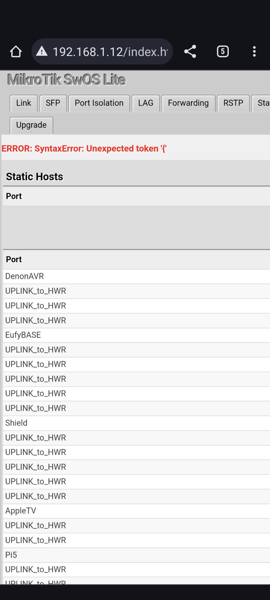

If I go to the hosts screen… after about 20 seconds I get this at the top of the screen.
ERROR: SyntaxError: Unexpected token ‘{’
yup, same here on two css610
I’m not seeing that.
Edge as browser on Win11.
Confirmed on CSS610:
O..K …it took a LOT longer then 20 seconds (just left the window open while I was doing something else).
Now I see it as well.
