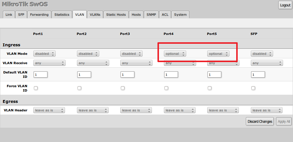

RB260GS requires VLAN mode set to “optional”, “enabled” or “strict” to be able to forward tagged traffic.

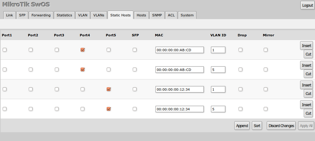

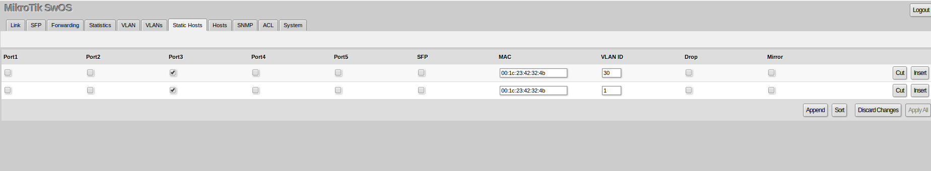

VLAN id 1 is for untagged frames. Additional Static Hosts entries with the same MAC but other VLAN ids are needed to make Port Lock work for other VLAN ids.

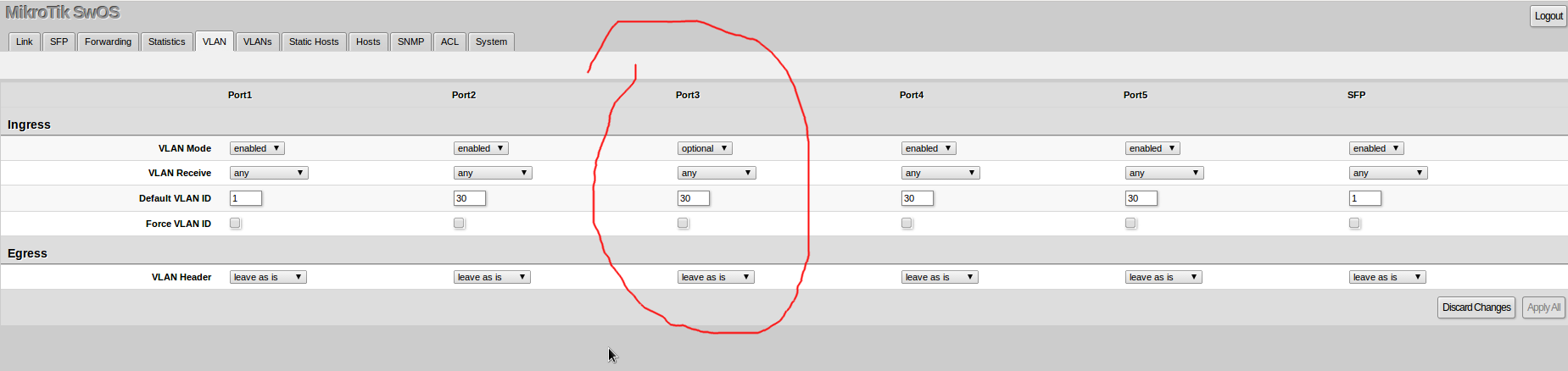

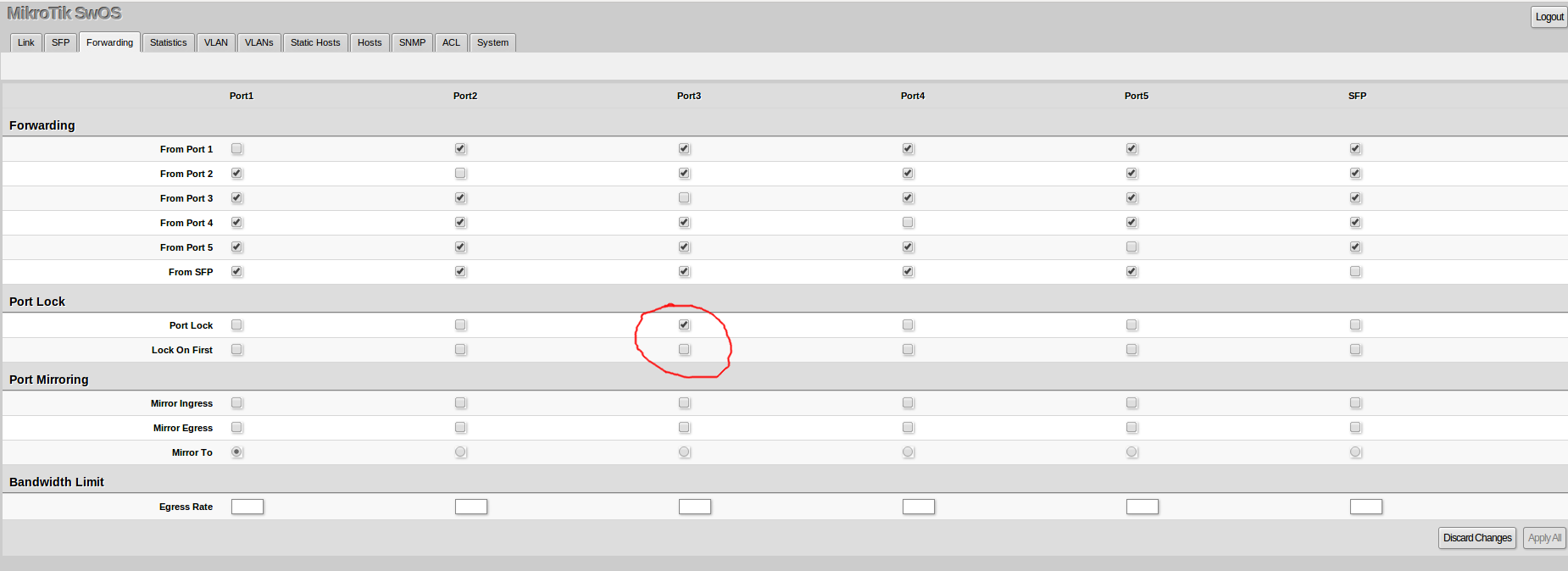

that is, you want to say that the port lock does not work for other Vlan but the first id? or pls, give me example working configuration with another vlan id and enabled port lock.

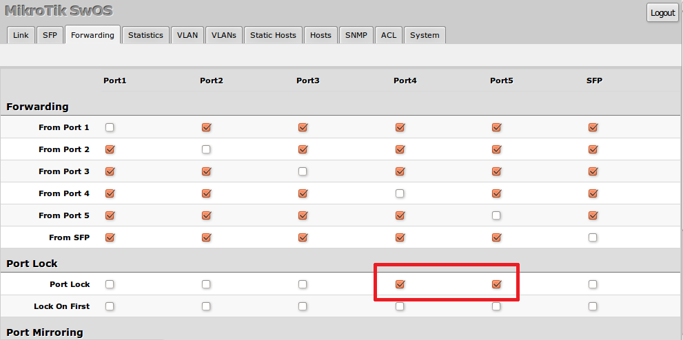

The following configuration sets Port Lock on RB260GS Port4 and Port5. It allows untagged (vlan id 1) and tagged (vlan id 5) frames between hosts with specified MAC addresses.
I need this configuration and it does not work
