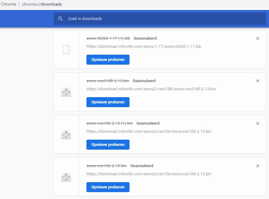

What surprised me was that Windows 10 / Chrome browser had problems downloading the file. The download never completes.
Disabling the firewall (Windows defender) gave complete downloads. (no complains in windows)
By comparing the 2 files, they are identical. Upgrade problem persists.

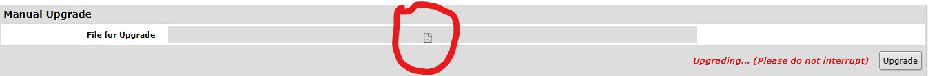

Tried to upgrade SWOS within a browser, it says version 2.13 found, starts the upgrade procedure and fails. reboots in FW 2.0, need power-cycle to get back in FW 2.12 …
Tried to upload the 2.13 to the switch, after uploading pressing the upgrade button starts somtihing and fails. reboots in FW 2.0, need power-cycle to get back in FW 2.12 …
so far no luck

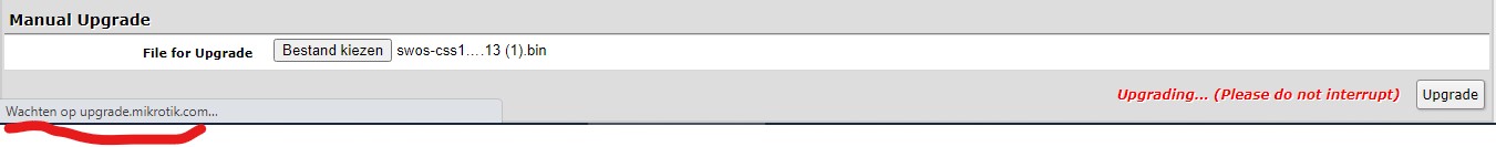

I had the same experience. In the second attempt (manually downloaded file) the browser still mentioned “Waiting for upgrade.mikrotik.com” after pressing the upgrade button. The file was already local, and the reference to it was entered, so what is the connection to upgrade.mikrotik.com for ? The file field changed in that “sad looking square emoi”.

In SwOS 2.12 on the Upgrade tab page the buttons “Download & Upgrade” and the “Upgrade” button seem to execute exactly the same code.
(Where the “Upgrade” button is supposed to use the local file, as indicated with “File for Upgrade”, it just seems to ignore this and tries to download just as the other button)
As the “Download & Upgrade” fails, so does the “Upgrade” button.
In a standalone and an Internet-disconnected scenario for the Upgrade, with already downloaded firmware, there is no progress with the “Upgrade” button, as the browser keeps waiting for http://upgrade.mikrotik.com. Something in “engine.js” or identical definitions in the html page?
