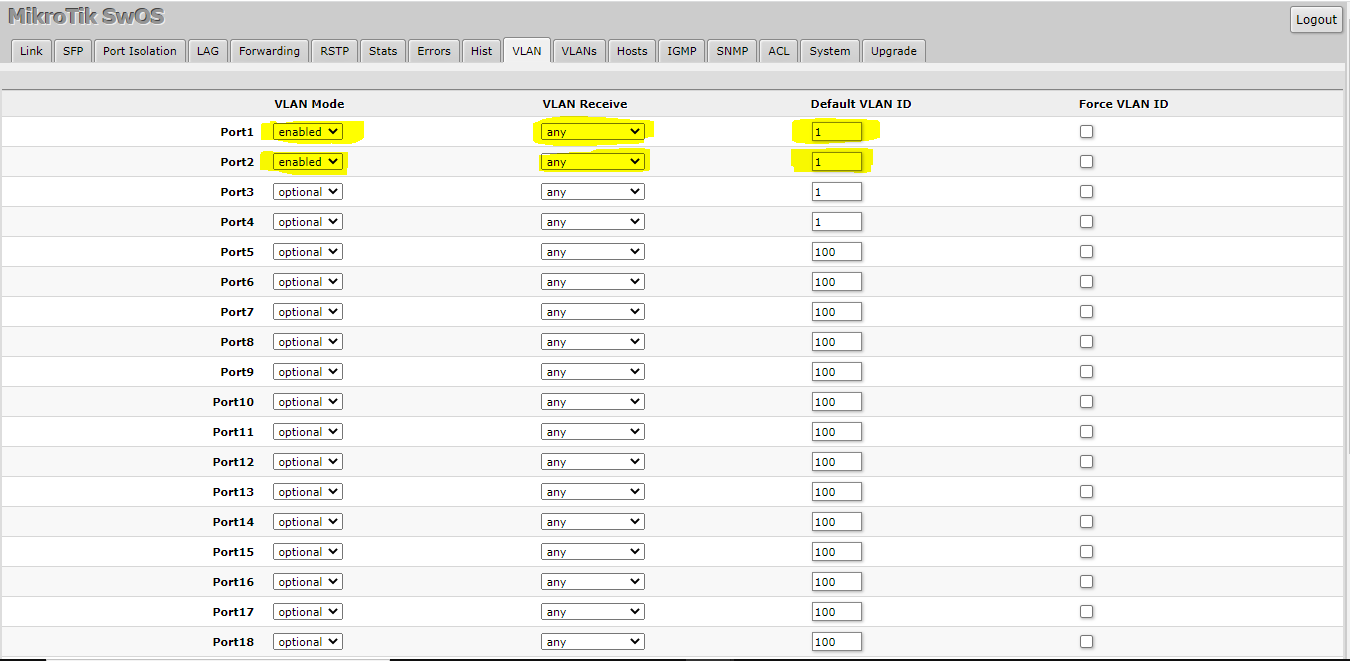

Hope you will be fine it is stated that I have a Mikrotik switch css326-24g-2s+rm. I want to configure the VLAN on switch.
Topology
on switch port-1 I have a PPPoE server LAN from the router.
I want to expand the PPPoE service through the VLAN on port 2.
and dial 10 PPPoE wan in pfsense.
So it’s a request to you please help me.
So port 1 will be access port of one of VLANs. You select which VLAN by setting value as “default VLAN ID”. Port can not be access port of multiple VLANs because switch can not distinguish between ingress frames as to which VLAN should receive each one.
As to multiple PPPoE sessions (if I understand it correctly): if pfsense can “play games” with PPPoE server, e.g. by using multiple different MAC addresses, then it’s doable. But not otherwise … PPPoE runs directly on top of ethernet (optionally VLAN) so server distinguishes clients by their MAC addresses.
@mkx you must be much better at mind reading than I am.
Well, I’m into guessing game today :wink:

@miankamran7100 I wrote this before your latest post. What “MikroTik” is that? That just raised more questions. Where does that fit into the diagram in your original post?
When posting MikroTik ROS router configs, please use export format. With SwOS, you have no option for a text mode config, but you do with ROS, and it is a much more “compact” way to post the “whole picture” concerning the config. Screen shots can give some non config information, (like packet counts, mac addresses, etc.) but at this point the /export hide-sensitive output would be much more useful to people that are likely to help.
I don’t have a CSS326, but I would have guessed the bottom row ports were “odd” and the upper “even”. (based on the POE IN which I would guess is on port 1)
But you have both ports configured the same.
That’s one reason I don’t understand exactly what you are attempting to do.

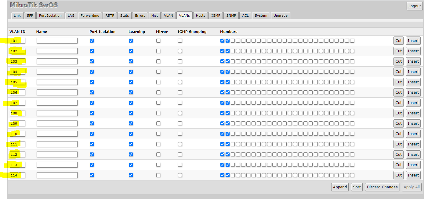

To me it appears you have the switch set up with both port 1 and port 2 configured as hybrid “trunk” ports with native untagged vlan 1, and tagged for 14 vlans, 101-114. Although I am not 100% sure what the switch will do with untagged. You don’t have strict defined, so even though you don’t have vlan 1 in the “vlan database” (it does not exist in the listed vlans on the VLANs tab).
Also it isn’t clear what you mean by “no vlan” for the top “pppoe server LAN”. I assume you mean untagged. But on the switch, every frame will belong to a specific vlan, and the vlans will be kept separated from each other. The only way that data will get from one vlan to the other is if there is a router that is vlan-aware, and it has “vlan interfaces” connected to the “tagged” vlans, and the router is allowed to route the traffic (there is a valid ip address on the vlan interfaces, a valid route (for connnected subnets there will be connected routes created automatically) and the firewall is not blocking the traffic.

You can’t configure SwOS the way you have it in ROS, SwOS only supports what’s known as “single vlan-enabled bridge” in ROS.
And even if you could do it, the magic of running N PPPoE clients is on the router - running one PPPoE client per bridge (on those you set MAC addresses to different values).
