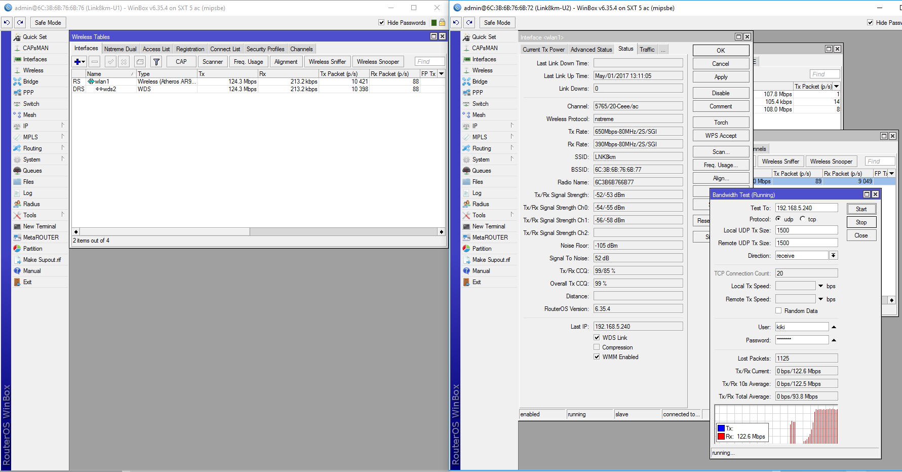

Yesterday I setup point to point bridge with two SXT 5 AC device but I have problem with bandwith.
Max bandwith is 170 Mbps when I copy files through bridge. Test bendwith in mikrotik say around 125mbps. Ping is excelent 1,2 or 3 ms. CCQ is around 90-100%
I try change all canals, but nothing better. I tried to change all protocols (nstreme, nv2, 802.11), but max bandwith is 170mbps.
Link distance is 750m.

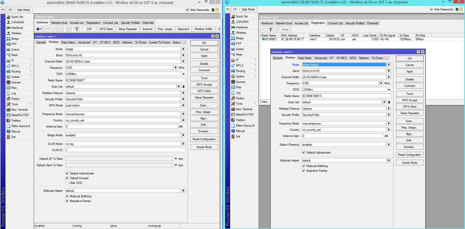

  1. Dont use WDS use AP/Bridge to Station Bridge
  2. How much is your EIRP?
Can you explain me how to use Ap bridge without WDS, what is EIRP? Where I can find this information?
Use Bridge and Station Bridge.
When I use Station bridge on clint side no connection between devices. Need I to configure something extra.
Ok. I understand. You can see in picture AP side is bridge, when I put client side to station bridge, no connection between devices.
I can’t see that.
Anyway you have made a mistake somewhere. Maybe the interfaces are not in bridge mode?
Sorry, yes interfaces in bridge mode now. Now I use WDS and bridge interfaces. I will post configuration when chhange to station bridge.
I tried bridge and station bridge. Device connected but no ping between. Do I have to config something else. Disable WDS or something?
This setup doesn’t work. I don’t know why.
You Need to Creative a Bridge with ether and wlan Interface
Need I add Ip adress on wlan, eth1, bridge?? Can this work without ip address?
Bridge does not need to have ip configured to be able to work as bridge…
