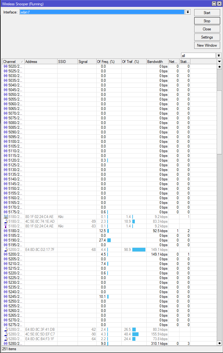

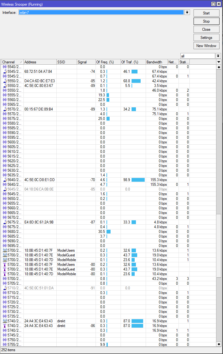

Scan tell me frequency 5765 is no used. I try put this frequency problem is same. Speed is no better.
How I can know what is best frequency for me? I tried randomly few frequencies but speed is same or bad.
And what Frequencys are used?
This tell me Frequency usage and wireless snooper.
