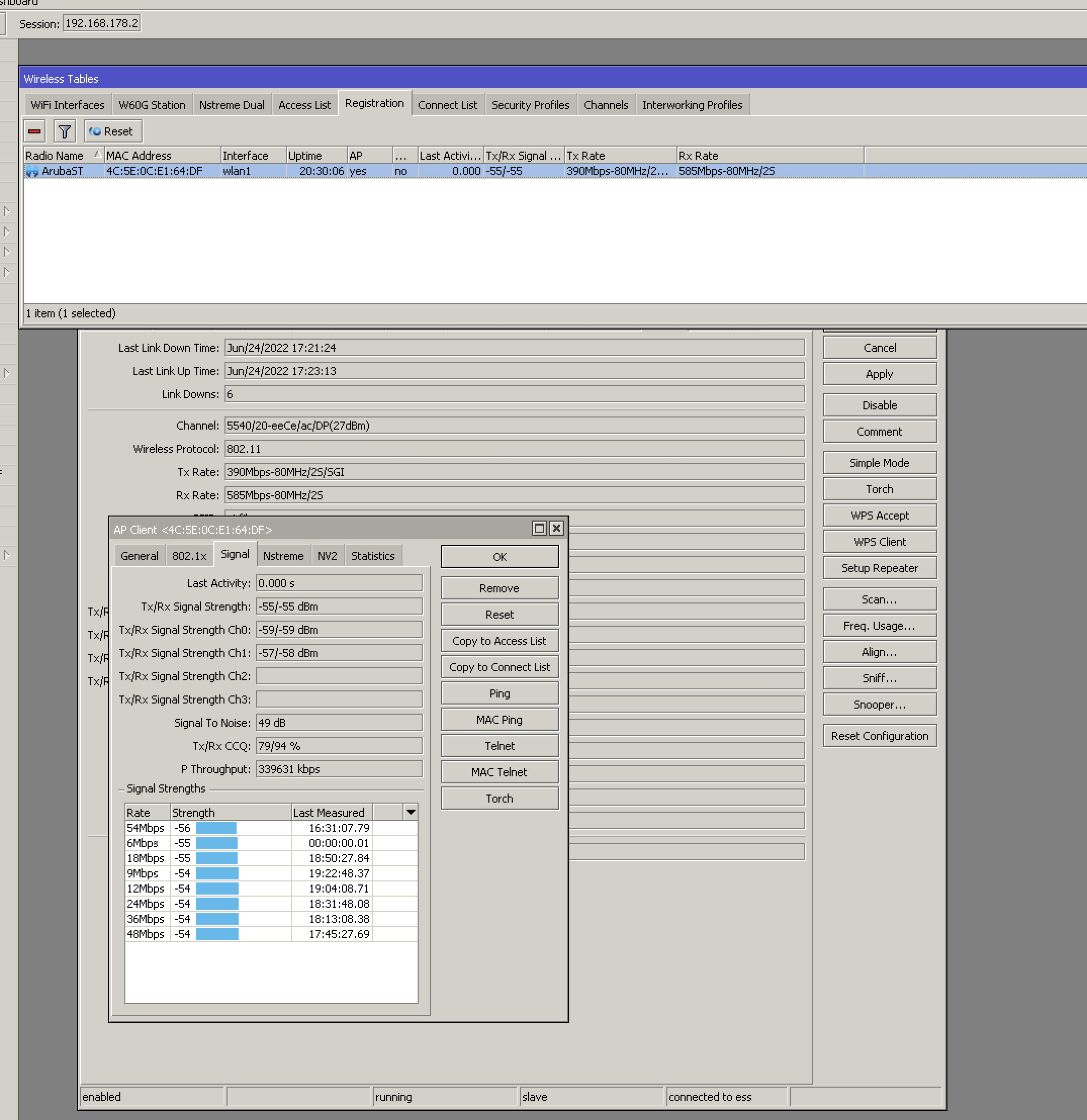

Bandwidth Test:

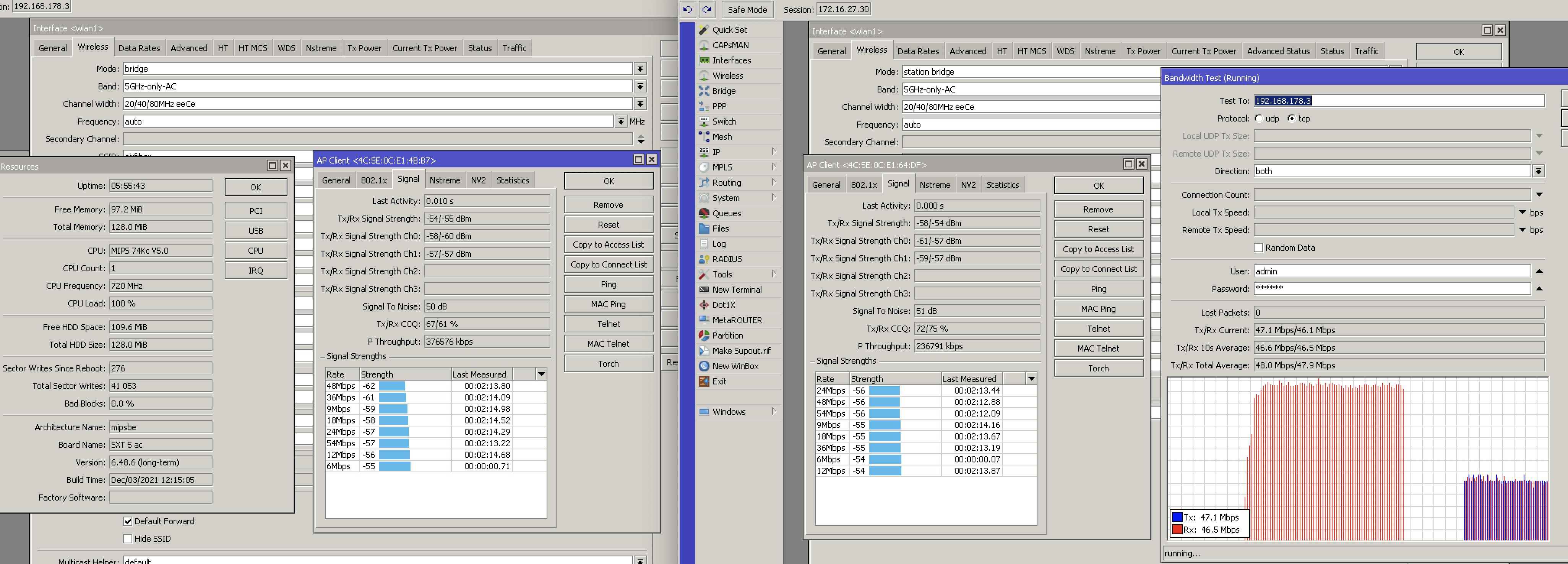

What is CPU load during bandwidth test? That is only single core cpu, it cant generate much traffic, use PC to do tests.
In idle, 3 -9 %, during the test 98-100%; currently i don’t have a pc on the other side but i can connect it and test via iperf
That’s the problem with your testing procedure. So yes, do the test using iperf through the wireless link.
According to radio stats it should be possible to push at least 150Mbps, 300Mbps is probably unreachable.
You are measuring the traffic that the SXT processor can generate. You measure it in the most processor-heavy TCP mode in both directions. Measure in UDP separately receive and transmit you get the highest possible speeds. You should not run the traffic generator on the device you are testing, the results will be biased.

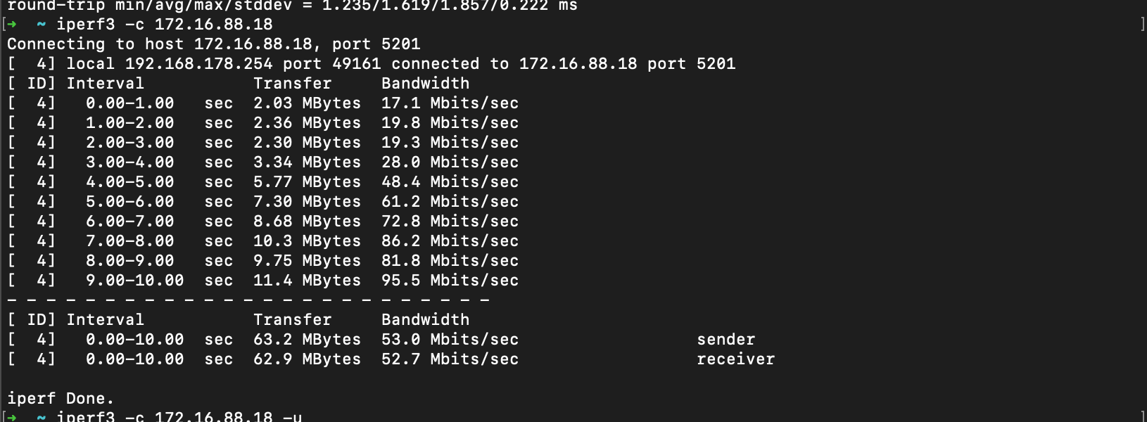

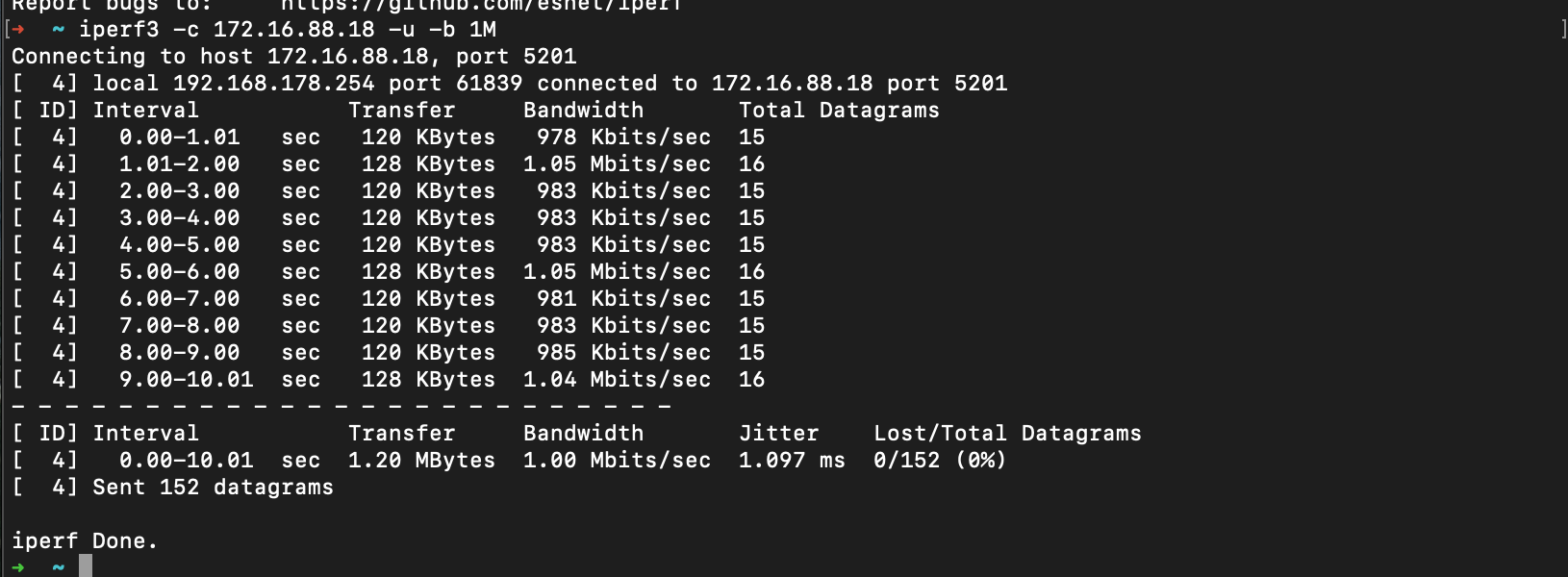

ok I did some tests but honestly the performances are very poor
You are testing both ways and over TCP, for that device and 2km its very good result…
Try testing one way only, and also try test UDP traffic, its not only TCP that will go thru that link…

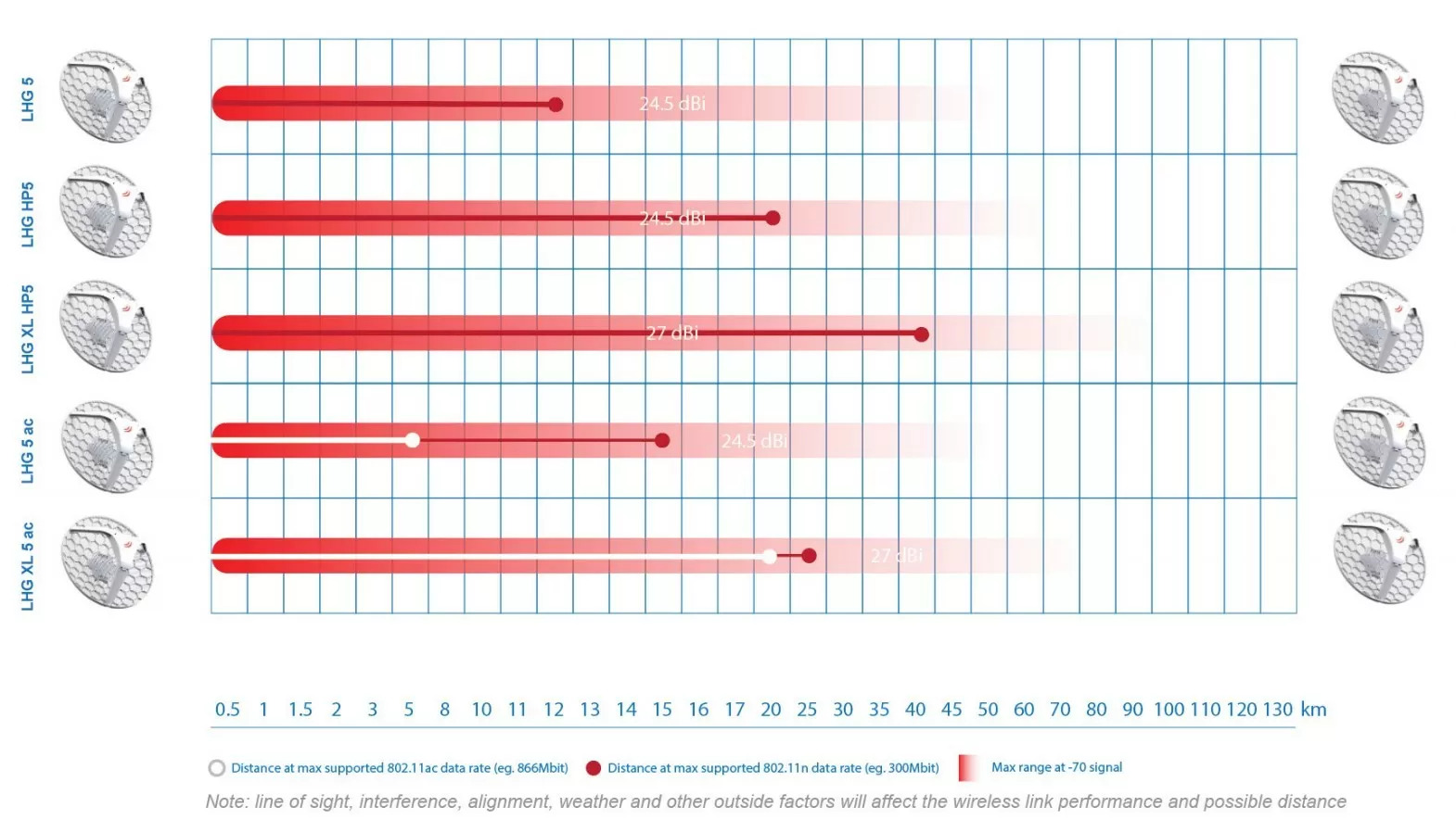

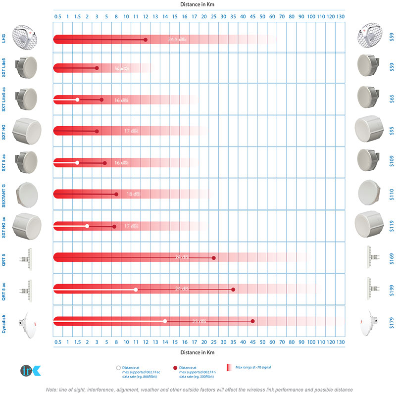

According to the scheme, the SXTs reach 1.5 km instead the LHGs at 20km for 802.11ac “866Mbps” but I have seen that the results are much lower so I am perplexed about it
Probably there are some reason if the dynadish cost more money than that lhg model…
the price from the supplier between dynadish 5 and lhg xl 5 ac, is really minimal, only 30 euros of difference
