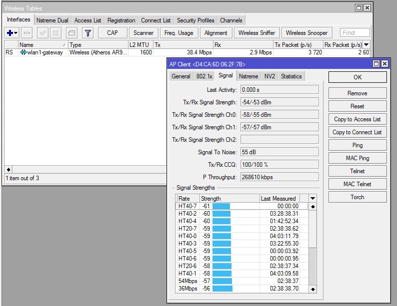

Here’s my first SXT 5 ac link:
Even if CCQ is 100%, signal is good (less than 1km link), the max throughput is about 105Mbps using these settings:

I switched frequencies during the night and I found a good 80MHz channel in AC. Speed is about 220Mbps both on upload and download, which is very good, using nstreme. Using nv2 or 802.11 I can reach only 95Mbps using nv2 and 150 using 802.11.
Using nstreme I have some “extensive data loss”:
But signal is very good, and CCQ is about 94-99%…
