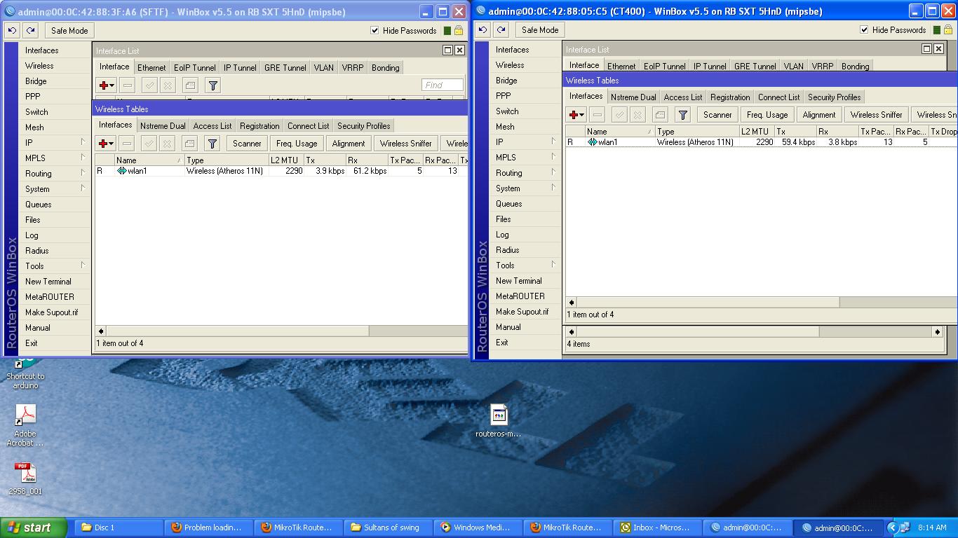

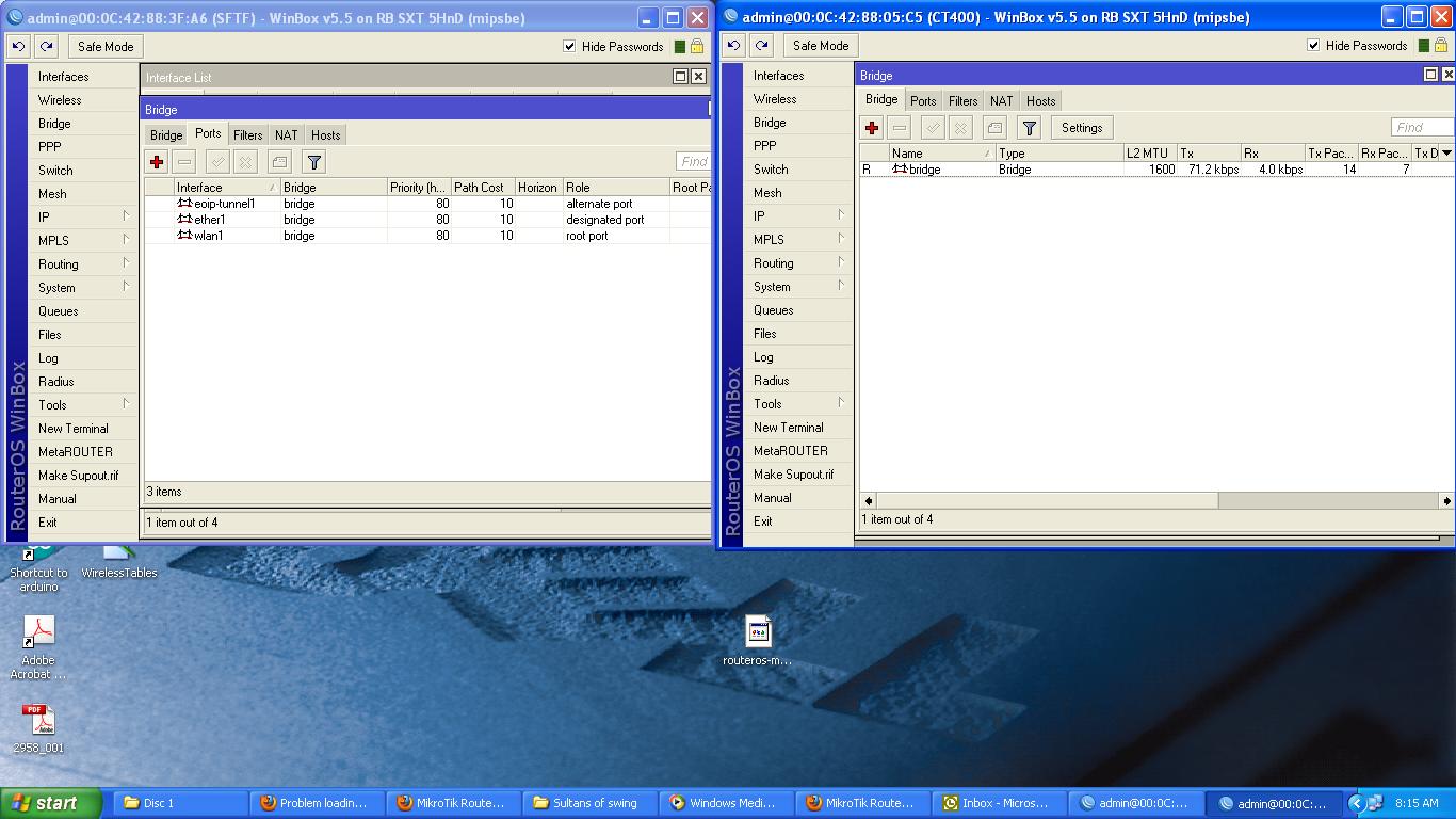

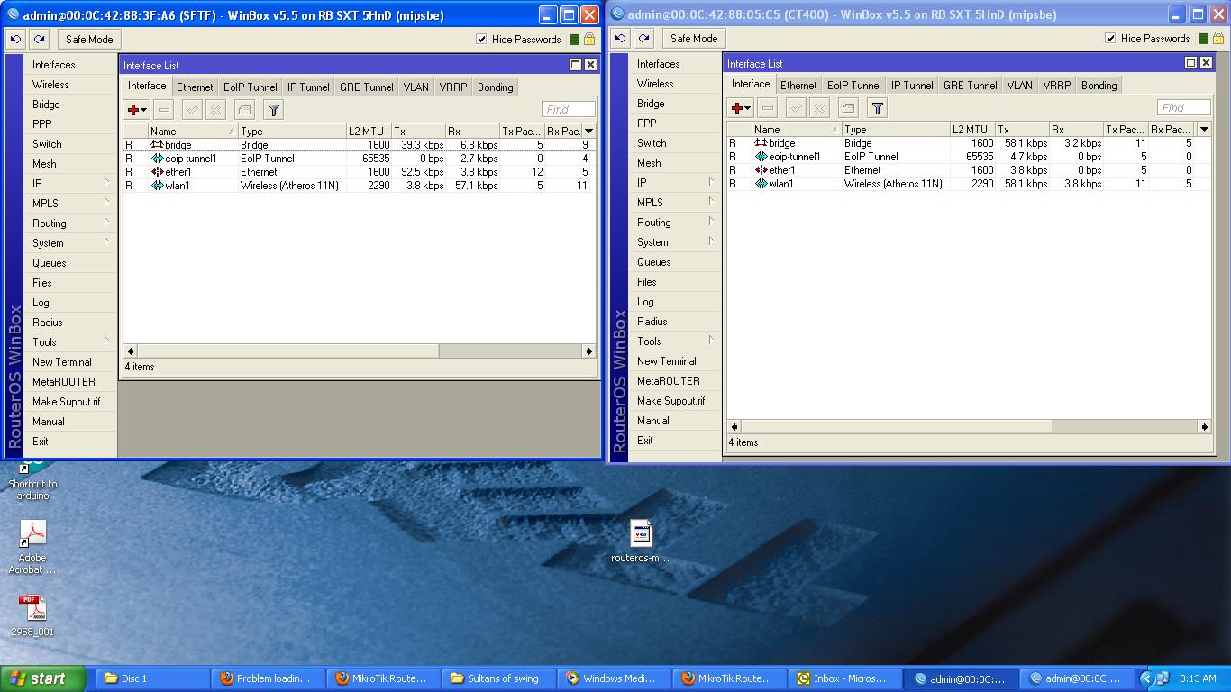

Would any one be able to help. I’m having connection problems with two of the STX 5HnD’s. I have been through many howto’s and i cant seem to get them connected correctly. The setup is as follows;
I have an Ip camera i would like to view remotely via computers connected to the router, then later i will add computers to the camera end.
Router (DHCP);
Ip: 192.168.1.1
STX 5HnD Unit 1, STX 5HnD Unit 2,
lan Ip: 192.168.1.10 lan Ip: 192.168.1.11
wlan Ip: 192.168.2.1 wlan Ip: 192.168.2.2
Camera;
Ip: 192.168.1.101
you can try the following:
Transparently_Bridge_two_Networks_using_MPLS
http://wiki.mikrotik.com/wiki/Transparently_Bridge_two_Networks_using_MPLS
the protocol used can be changed for higher speeds… as per requirment.
