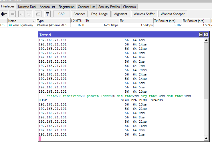

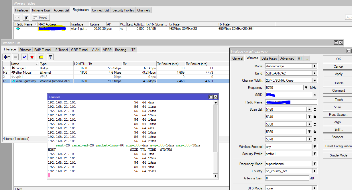

i have link with sxt ac on 2 km , signal is ~55 - air rate ~ 585MBps 80mhz , real tcp throughput is ~120-180mbps and latency is very unstable ( start’s from 0 ms and big is 80 ) .
first i set on wireless protocol : nv2 but not working well , next set nstreme and same situation , on this time i use 802.11 and more stabile but with unstability latency
i upgrade from 6.16to 6.18 and 6.19 os and same result.
when tcp usage more than 100mbps

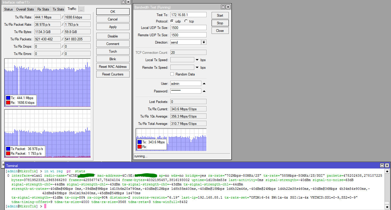

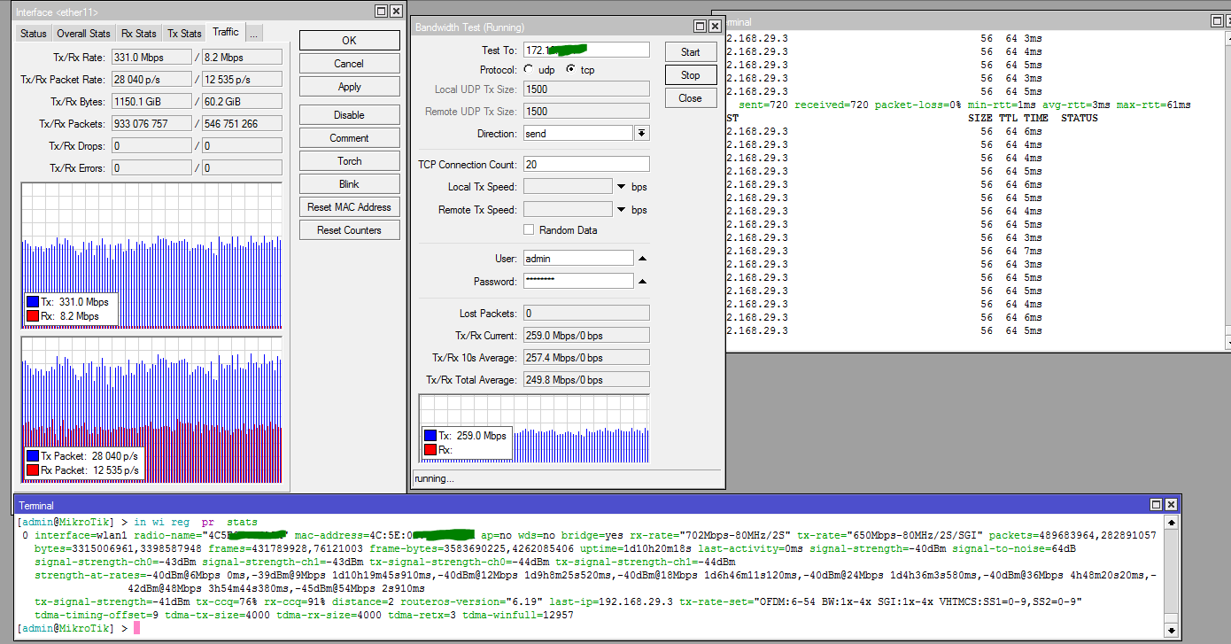

My picture proved you are wrong, radios are connected with 802.11ac and nv2.

Since when UNSTABLE is writen unusable? When did you learn to read? My picture shows is not unstable or unusable anyway.

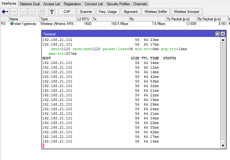

now i set a/n mode with nstreme and max throughput is ~120mbps in tcp mode and ping better than previos situation , also on a/n , only-n and only-a/c i attempts custom channel with 30 mhz bandwidth and its say that not supported :confused: ,
