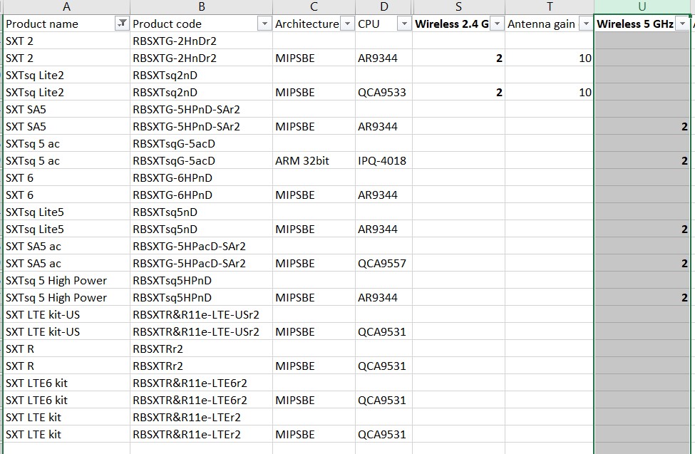

Still confusing. I have no knowledge of any SXT with 2.4GHz radio and 5 GHz radio in the same device. Both executions (2.4GHz and the 5 GHz) have “WLAN1” as default for their wifi interface.
How can you connect both to the bridge in the SXT?
There is also “wifi 5” and “wifi 4”, but that is about simple names for 802.11ac and 802.11n
The hAP ac3 has 2 master WLAN interfaces, one in the 2.4GHz band, and one in the 5 GHz band. Probably named WLAN1 and WLAN2, as in other MT devices.
The SXT 5 with “also” 2.4GHz radio intended ONLY for LOCAL MGMT is discontinued:
https://mikrotik.com/product/RBSXT5HacD2nr2
