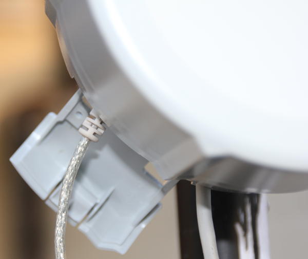

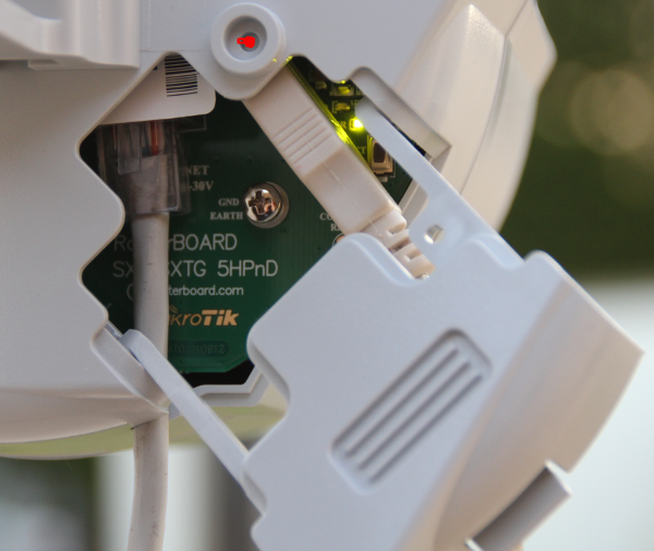

I would not reject Mikrotik equipment.
SXT has a note.
I doubt the water resistance of the device.
Door can not close with inserted usb stick.
screw for door lock cores in usb plug.
There is no place for usb plug.
Sorry Mikrotik there is still work to these devices

I want to be sure this device is water resistance.
Usb is not so important to me but i try it out with a simple usb cable.
A usb-stick from 4 cm don’t fit in it.
