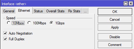

I see. In Winbox terms, I assume this means that the radio buttons in the window below are configuration desires, not a reflection of current operation:
and that the “monitor” value is the (optional) “Speed” column in the Ethernet interface window.
Are the radio buttons for limiting the maximum rate? Because it appears that if I set it to 100M, it will never auto-negotiate up to 1G, even though the line is capable of 1G.
Yes, it works like a substitute for simple queue. Normally, don’t use that option at all.
