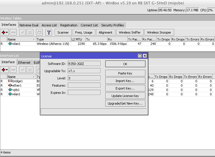

SXT G-5HnD shipped with L3 License?
Hello everyone!
I’ve just got two of SXT G, but what a surprise when I looked at License menu. Interesting how then it can be used as sector AP as the product description states http://routerboard.com/RBSXTG-5HnD?
Mikrotik comment please.
you can use your device as wireless/bridge ..with just one wireless client ( p2p ) connection …
you have to buy a license 4 code from mikrotik company .
You have no ideea about you are talking. Keep quiet and read again and again.

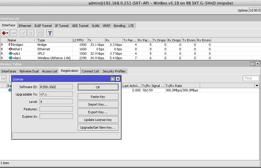

To fix this, simply click that “UPDATE LICENSE KEY” button in the license menu. It will connect to mikrotik.com and get correct license
Thanks.
After update and reboot Level 4 license loaded on both SXT G-5HnD devices.
Would be good idea to inform distributors and resellers about L4 update availibility, because most of them don’t even know what in the box.
