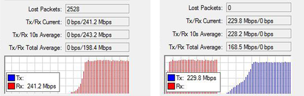

I have 1 km link tested with sxt.
With 802.11 and Nv2 protocol.
Here the result

Cool, where you able to test 40Mhz channels also?
40 Mhz bandwidth will still be tested.
This is the result with 40 MHz Bandwidth
Is the latency of 6-7 ms I see on the images normal? I thought it would be less. Where does it come from? Wifi mod/demod or packet transmission time (not the radio wave speed), inherent device latency, or something else?
I think this is the property of Nv2.
Nothing abnormal.
I experience this at every link test with Nv2.
Nothing to worry about.
try to test with the latest RouterOS v6.19 and the wireless-FP package. there will be less latency for nv2

good job, its nice to see this kind of tests
would be nice to see the actual phy rates at the moment of the tests
