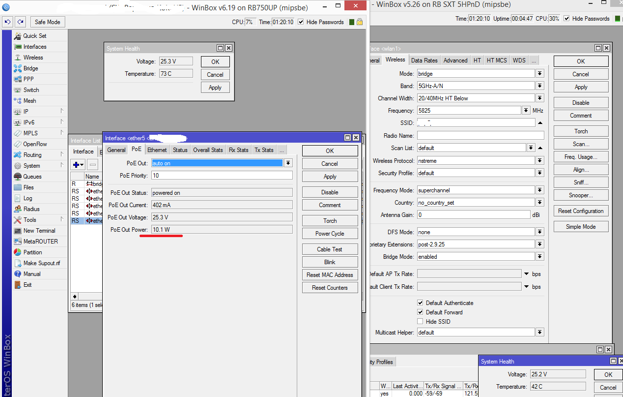

SXT HP power up by 750UP showing 10.1W con.???
After upgrade from 5.26 to 6.19

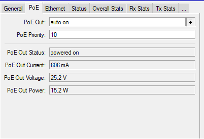

SXT HP powered up by 750UP on ether5 port it is showing 10.1W consumption is it possible or its just a sensor mistake?
it should be something about 3.5 max 7w.
I use 3m cat5e from RB750UP to HP
on other ports consumption is normal 2-4W per port
When I do BTest (50-60Mbit) its showing 14-15W consumation :slight_smile: ???
Its just not posible
it seems like sensor mistake.
On other ports it shows same values?
On outer ports 3-5 max 6W
Ive replace units cables from port5 to port4 (vice versa) - problem persists (probably sensor) port5 continue showing 10-15w consummation
