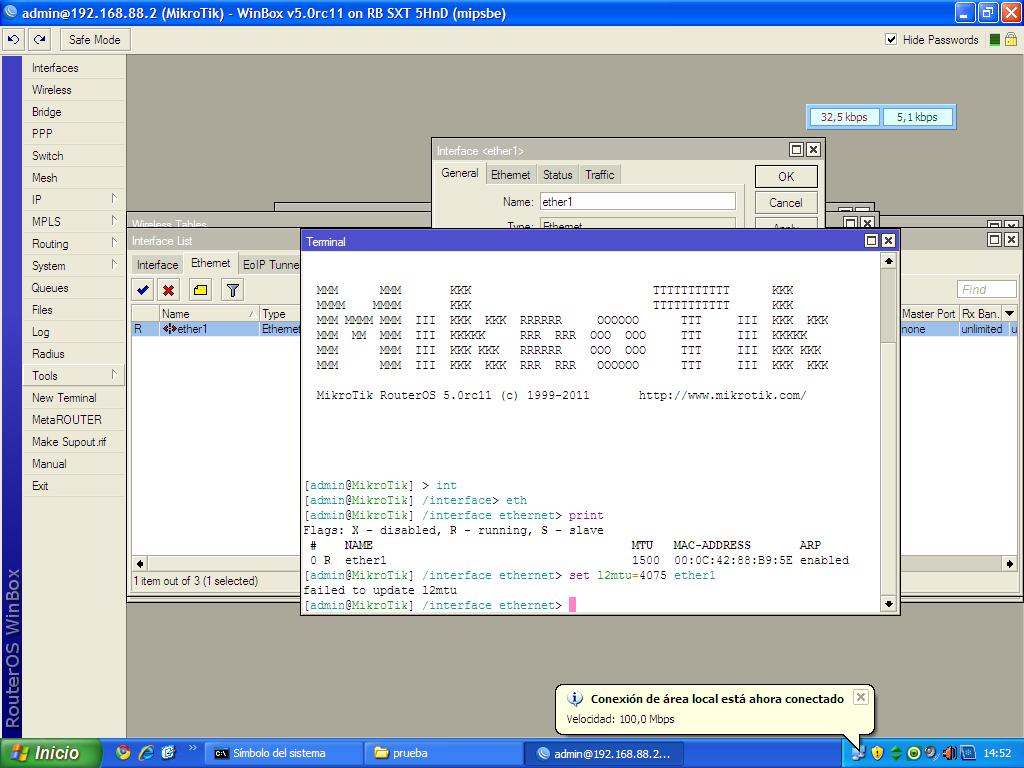

SXT L2MTU only 1600 on ether1 not 4075
hey guys according to the datasheet of the SXT the L2MTU is upto 4075, but I only can set it to 1600
Try from console, or close winbox, and open again. It should work. Works for me
the same thing, maybe these batch are using normal AR7240 not the AR7241
ok, try to update Firmware, see if that helps. Did you reboot? All SXTs come with the same CPU 7241
still not working.. I just upgraded to the lastest
what can be the problem ?
email supout.rif file to support@mikrotik.com, we will check why
the documentation has an error the L2MTU is upto 2030
