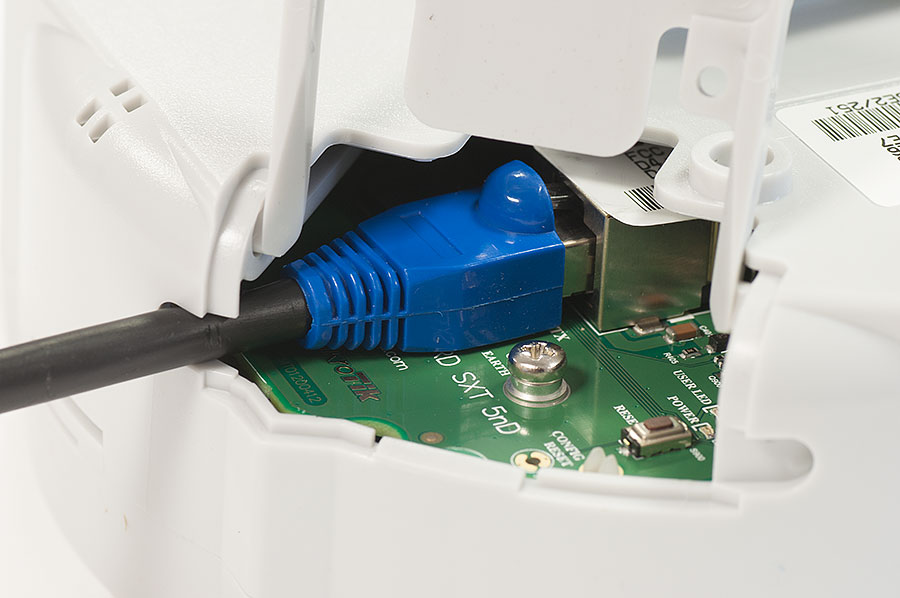

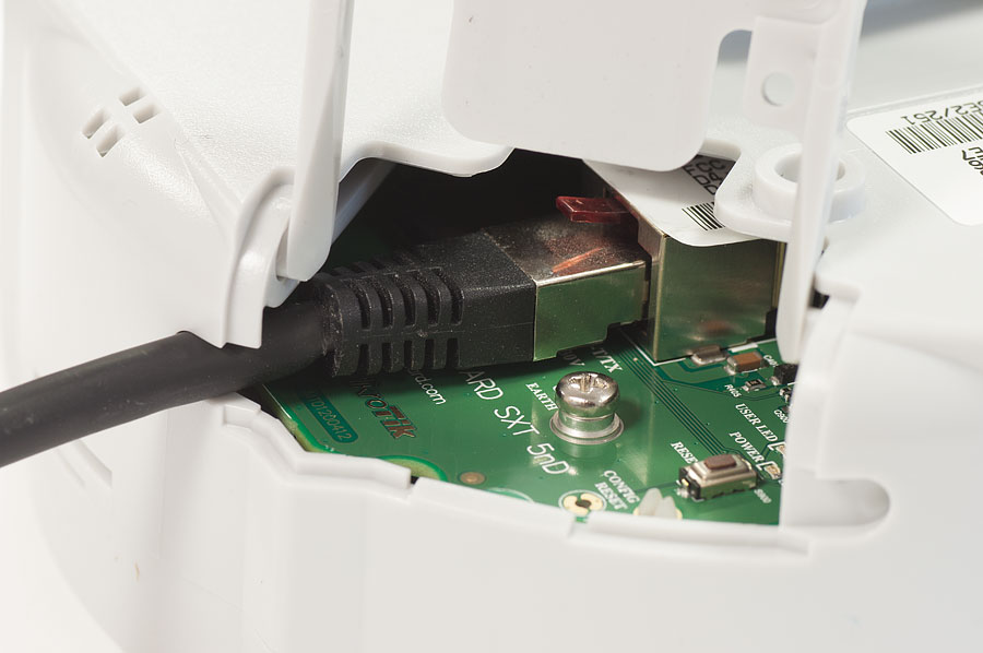

How is the Ethernetport of the SXT-Lite5 designed?
Does cable with Kink protectors fit as with the 5HPnD.
(First SXT-Series had to low space between port and housing).
These are the fattest cables I could find at the moment. The cable is completely straight and I had no problems plugging and unplugging of these:

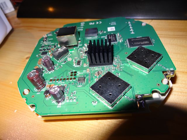

SXT LITE5 - wireless part is very small. See image
Antena - the same is in SXT-5HnD
For comparison:
Old SXT - http://www.air-stream.org.au/files/SXTMod-1-PCB.jpg
i see non solid capacitor there… :confused:
