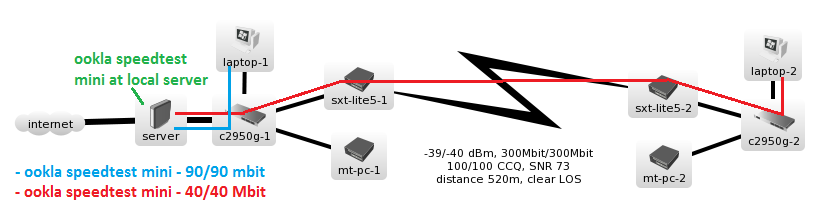

i have problem with throughput/speed at 520m link working on sxt-lite5/mt6.7 802.11n (no nstreme, no nv2).
  1. speedtest.net mini, instaled at server from laptop-2 i had max 40/40 mbit
  2. speedtest.net mini, instaled at server from laptop-1 i had max 90/90 mbit
  3. bandwidth test (10 connection) from mt-pc-2 to mt-pc-1 —> 80/80 mbit
  4. bandwidth test (1 connection) from mt-pc-2 to mt-pc-1 —> 31/25 mbit
  5. real internet traffic from sxt-lite5-2 to sxt-lite5-1 —> 40/25 mbit
why test 1 result is different from 2?
why test 3 result is different from 4?
i try bridge/vpls/station bridge/pseudo/wds/nstreme/nv2 and change frequency, and i cant improve throughput of this link…
how i can improve this link? what is bottleneck (sxt cpu, latency)?

look at picture description, i had 300/300Mbit than i must have chain 0 and 1 included :wink:

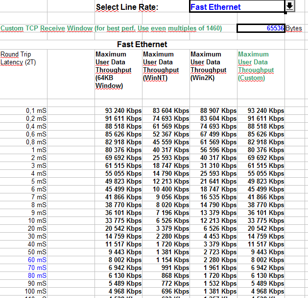

i found this: http://www.babinszki.com/Networking/Max-Ethernet-and-TCP-Throughput.html,
click “Skip ahead to the TCP/IP on Ethernet Performance Model” and download excel spreadsheet,
open it, change “select Line Rate:” from “Gigabit Ethernet” to “Fast Ethernet” and look at
it say that with rtt 3ms max throughput is 60mbit.
i had rtt 2.7ms, but wireless link 802.11n is halfduplex.
if this is the reason that I cant reach better throughput that 40mbit with ookla speedtest mini at local server?
how i can improve rtt at my link? how i can improve my link?

i think that i cant explain users that 40mbit (local!) speedtest is equal 90mbit 20 ftp connection :wink: its more complicated that build my simply network

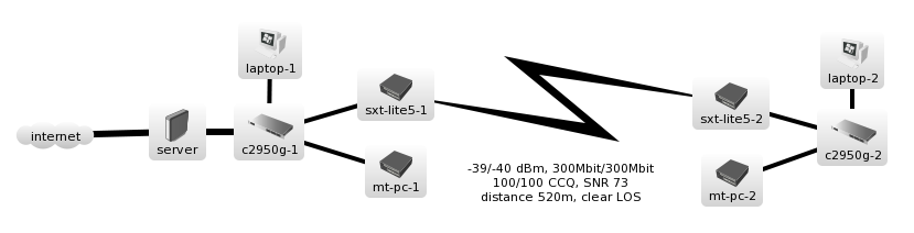

please read carefully my first post and see atached picture. i attach modified picture, you should understand it all…
like you see at attached picture its ONLY ONE wireless hop and 2 standard cisco switch and one linux server with ookla speedtest mini.
its works ok without wireless link on mikrotik, with wireless link on mikrotik i had more than 50% worst scores at speedtest…

if i understand links that i posted below in case of gigabit lan and rtt 3ms i will have max teoretical throughput 147Mbit, it will be very funny…
