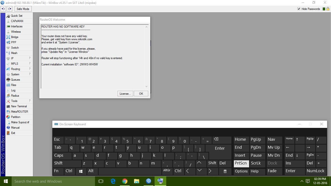

I have a few SXT Lite5 with me all of them go through the same problem of having license level0 instead of level3.
The devices when opened in winbox give a message saying that I have 72 hours to purchase and install a new license otherwise the device will stop working.
What actually happens is the device resets to factory default after every 72 hours. I am quite fed up of this and am considering to replace the setup with products from Ubiquity.

Somehow the license has been damaged or destroyed. All you need to do is email your supout.rif file to MikroTik support to get a new license.
Thank you for such prompt reply. I shall do the same and hope to resolve the problem. Thank you so much for the guidance.
