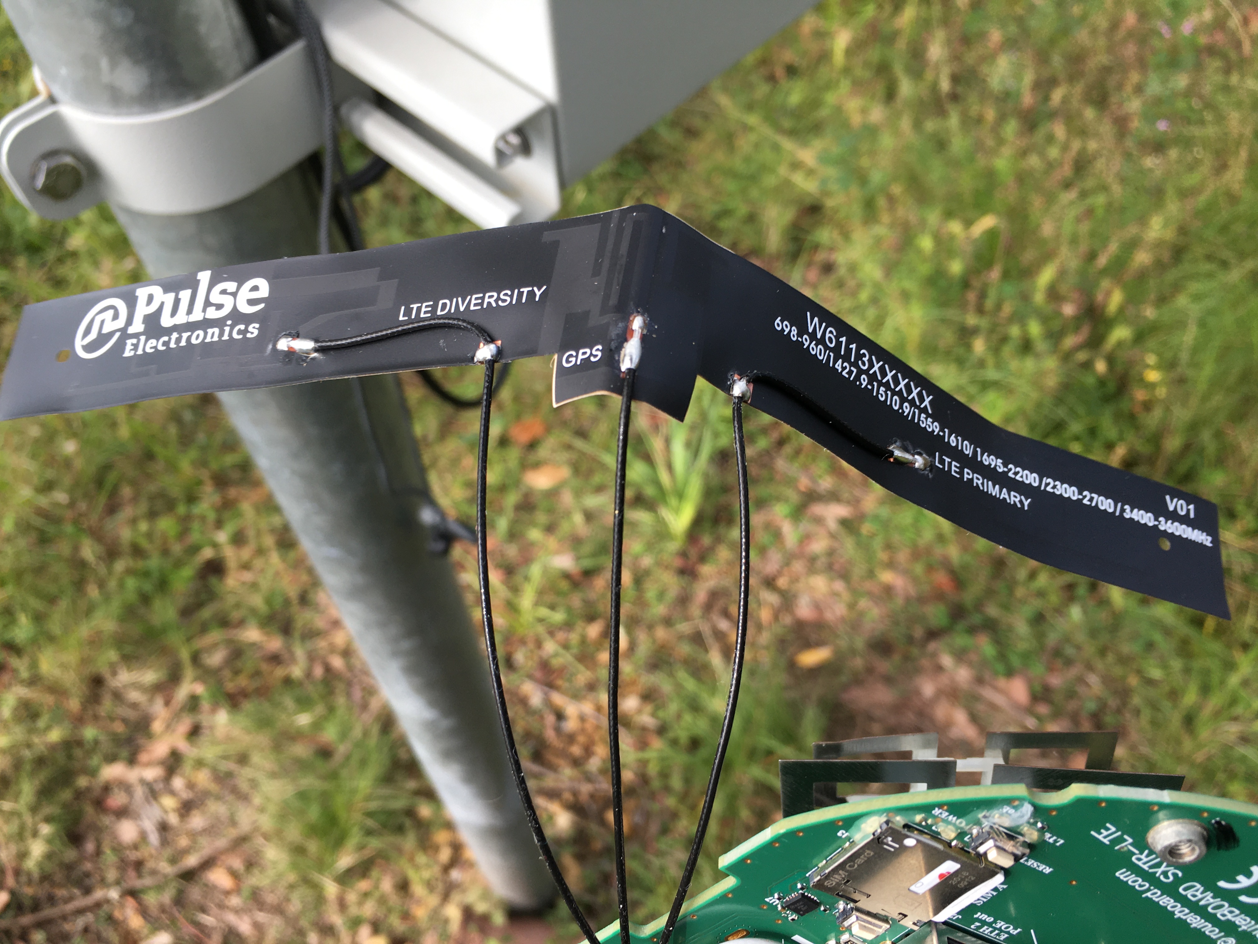

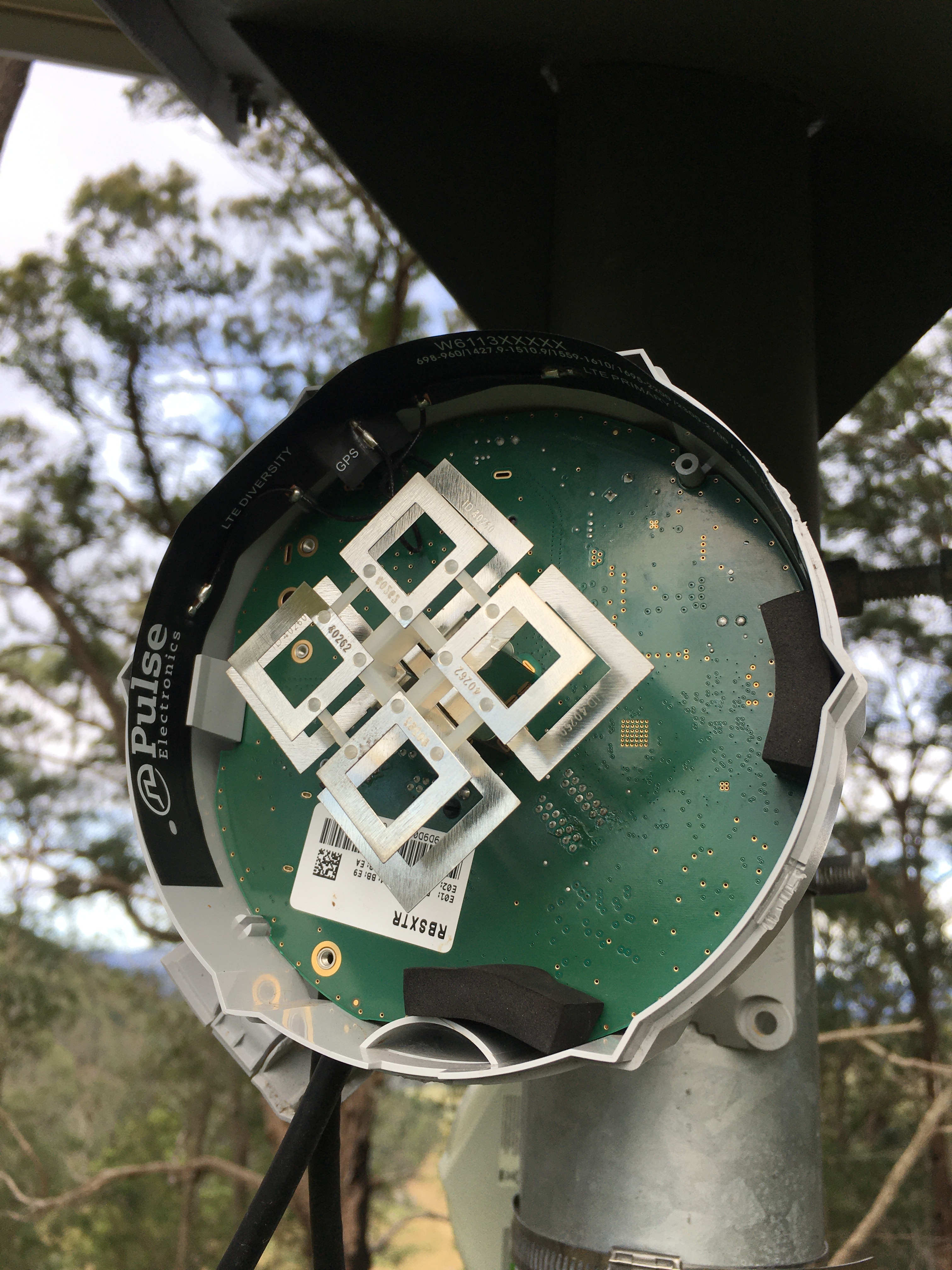

To see if I could utilize a B28 tower that is 10km away, direct LOS, I’ve been testing one of these antennas from Sixfab. The problem as many know is the SXT and LHGs are useless for lower frequencies if it is some distance from a tower. The antenna I’ve been testing has 2.9dBi peak gain and flexible with 3M adhesive on one side. The leads (main, diversity, GPS) are poked around the edge of the PCB and is stuck to the inside of the bottom half of the SXT enclosure.
Sixfab antenna 2.9dBi + B28 @ 10km averages 40Mbps, peaking at 55Mbps
SXT antenna ~7.2dBi + B3 @ 26km averages 10-25Mbps, peaking at 35Mbps
Overall, I’m quite impressed with the results. US$12 to add B28 support to a SXT without any need to physically modify the enclosure/existing antenna, plus is completely removable.
