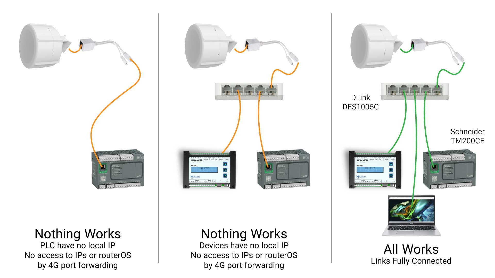

I am working with a SXT LTE Kit connected to a 4G network and a PLC, modem configured to forward some ports too.
Oddly by turning on the supply, device doesn’t connect to the network and no PLC get the ip neither we can connect to the routerOS panel from remote, but instantly just by connecting the laptop (with a small switch) everything becomes ok and disconnecting laptop doesn’t affect on PLC and remote connection.

I made a simple topology map to explain three figures. FYI, I test both static and DHCP IP address for PLC.
Unfortunately you still do not provide enough information, be clear and concise.
A simple picture is not telling us much more.

In image 1, how can you determine the PLC has no connection to the SXT ?
In image 3, what is the computer, what is it about the computer that makes it magically work, you need to give details, is it a Windows laptop or maybe a GNU/Linux, we have no idea.
