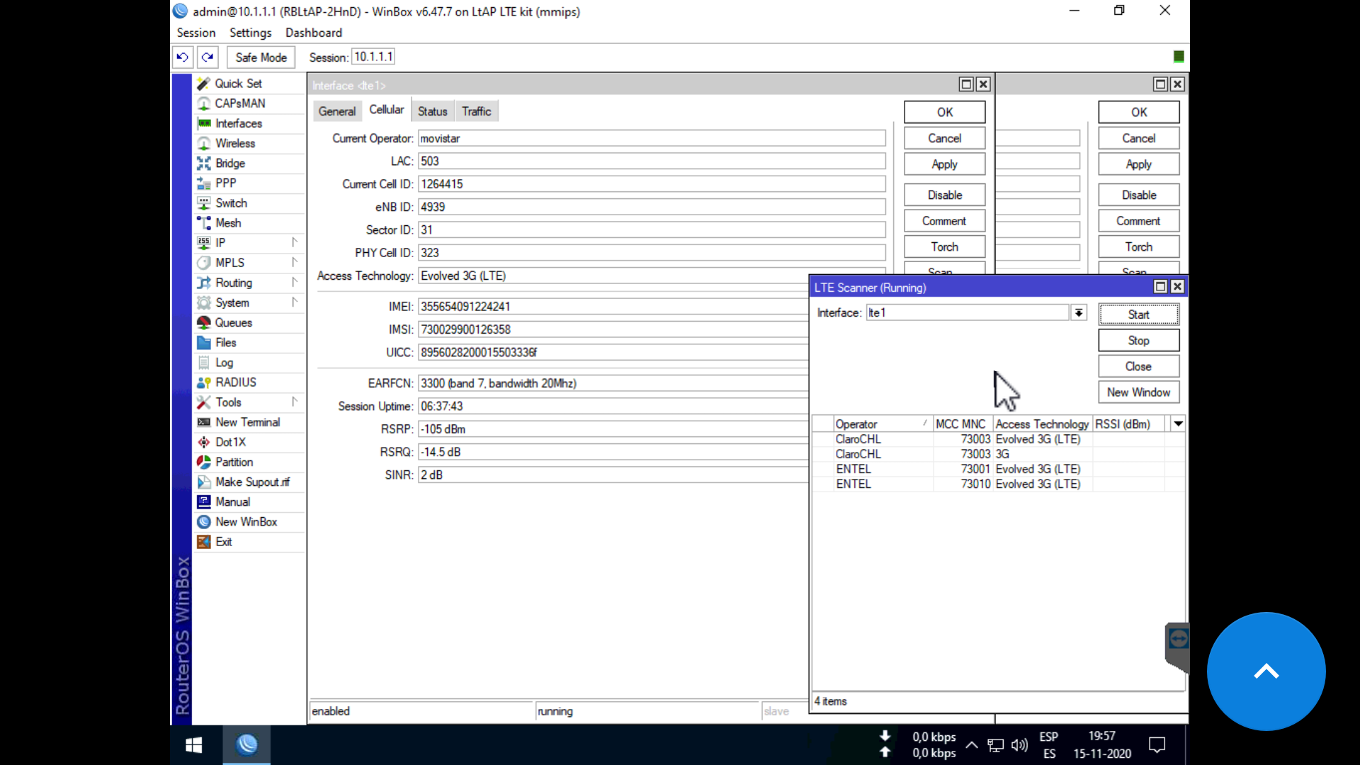

At r11e-lte6 I activate band who not exist, band2 and scan not detect any ISP.
When I use proper Band then Scan works and detect others ISP.

It may also be your ISP. Here in Australia, Scan has never worked. You can only see your ISP and that is all. At least for Telstra.
I think I’m now pretty certain it’s just not supported on the older modem. A colleague has the Cat 6 version, using the same ISP (although a different mast and cell) and scan works for him.
