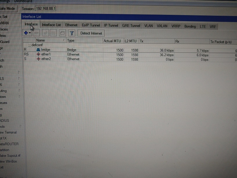

Hi all,

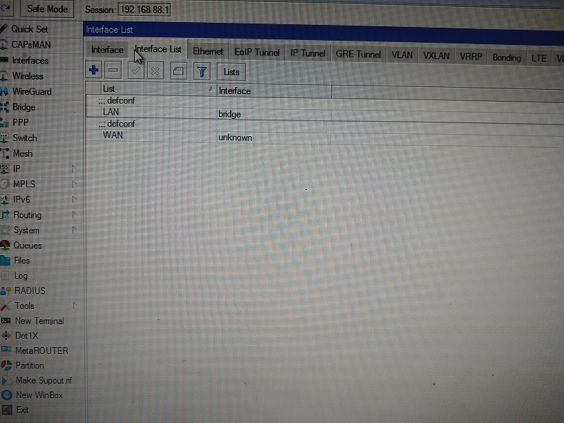

Was called out to a customer today reporting no internet, they have a SXT LTE RBSXTR&R11e which is 3.5 years old and has been running without issue. I took a look at the OS and in the interface the lte1 has dissapeared. In the interface list the WAN says unknown!. I’ve got the unit back to the workshop and removed/reseated the modem but no change, I’ve reset the device, downloaded the package from 6.48 down to 6.45 and still nothing.
My suspicion is the modem has stopped working but with availability of replacement units some months away am looking to see if its possible to keep this one working. I can get a replacement modem from my supplier but how can i check it is 100% the modem and not the router board?
Ideas and suggestions always welcome.
Joe.

Could be hardware.
I’d check what shows up in /ports and /system/resources/usb - see if the modem (and its ports) are showing up. I’ve seen the “port” can get lost, normally just doing a physical power off of the SXT (e.g. not just reboot), might try a few times. Or, if the port show as “red”, could delete it…it should be detected again after a hard power cycle too.
On the software, I think it’s most important that the modem firmware was update. And the USB/port/modem stuff like the ROS firmware (/system/routerboard) and version matched (/system/package).
just to update this post, ordered a replacement modem and unit now back working properly. Also took the opportunity to upgrade everything including firmware.
