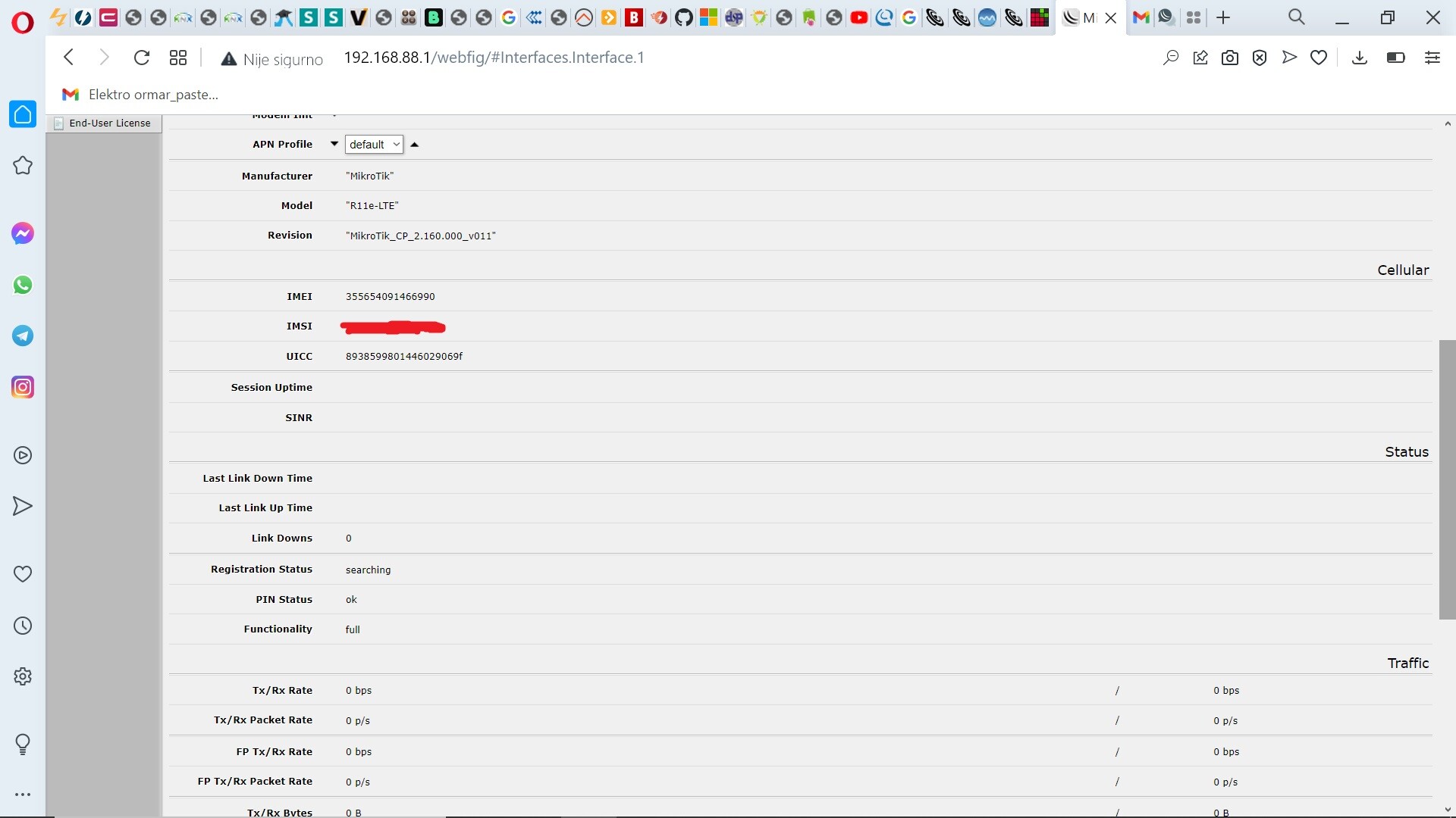

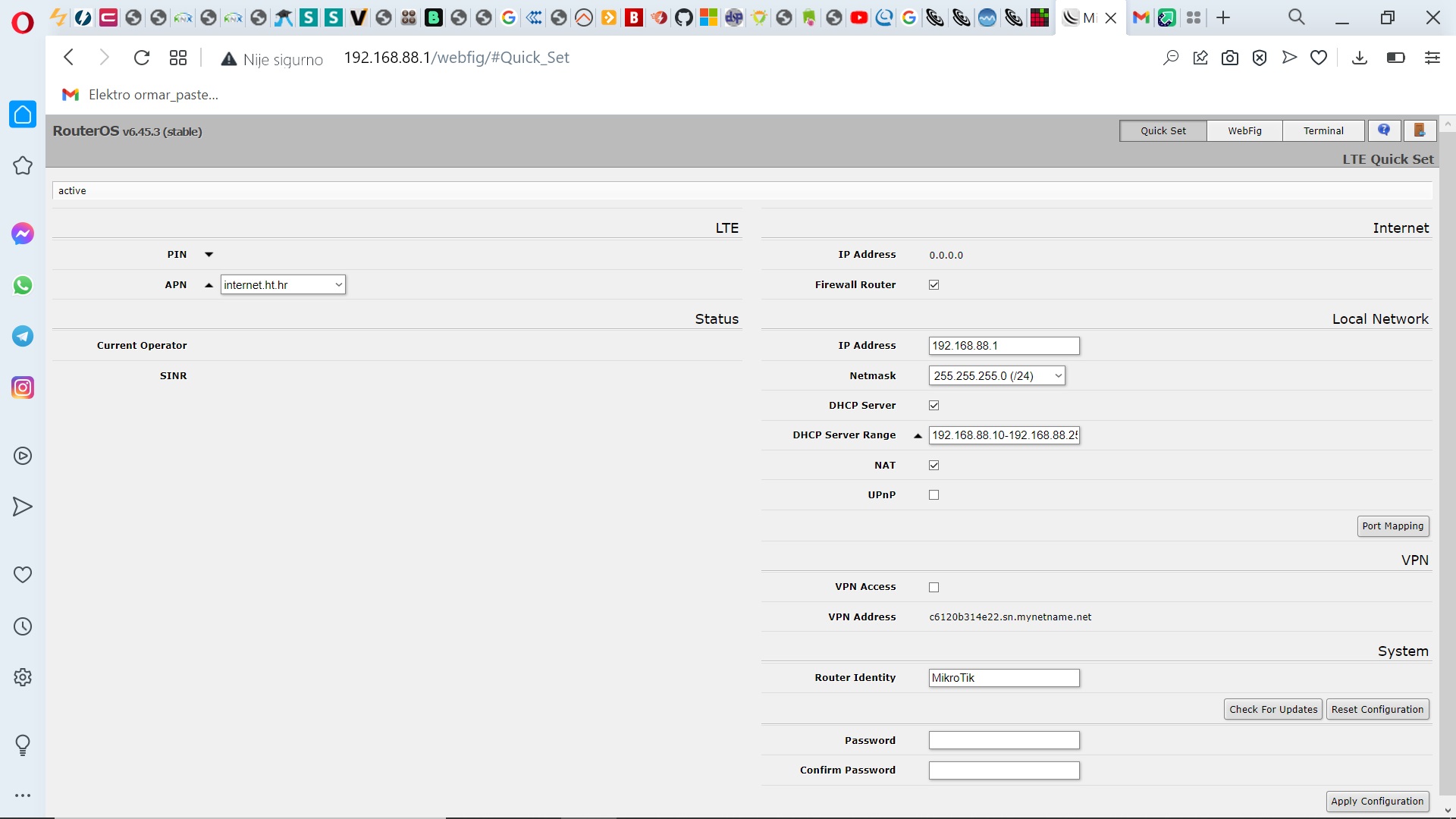

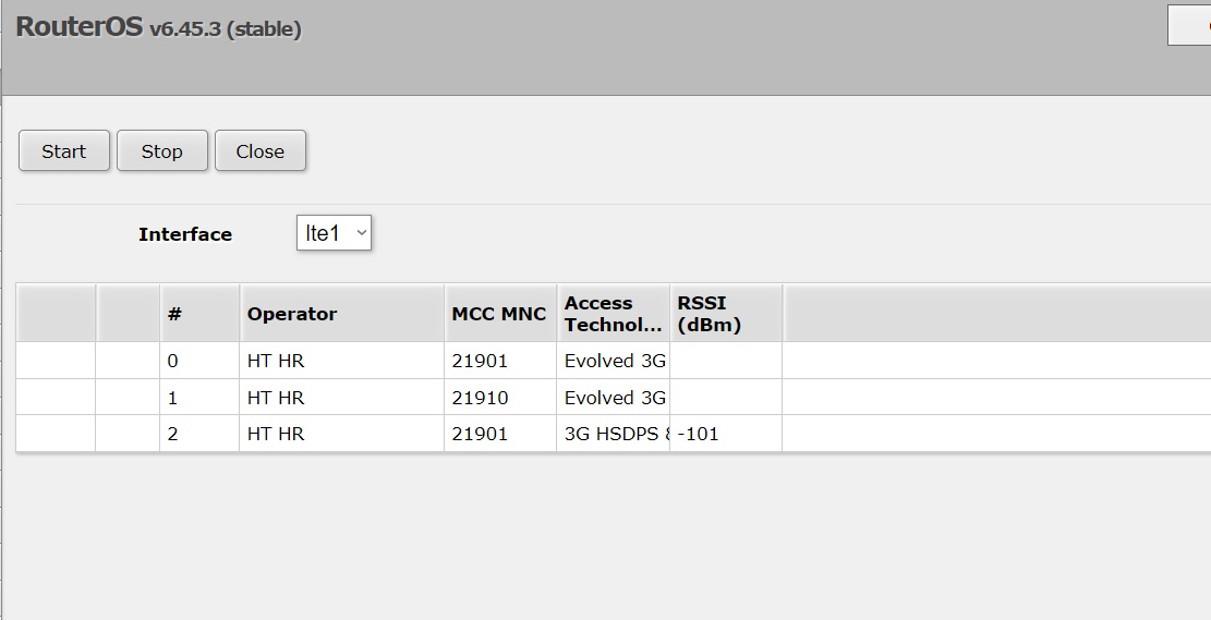

I ordered two SXT LTE modems for my customers. The first one workes just fine, when I insert the SIM card and find direction it works. I have a problem with the second one. Same position and the same SIM card and there is no signal. I need Your help to find the solution.
