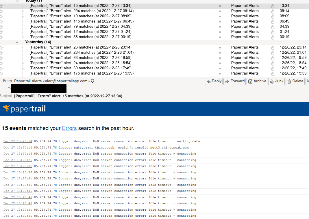

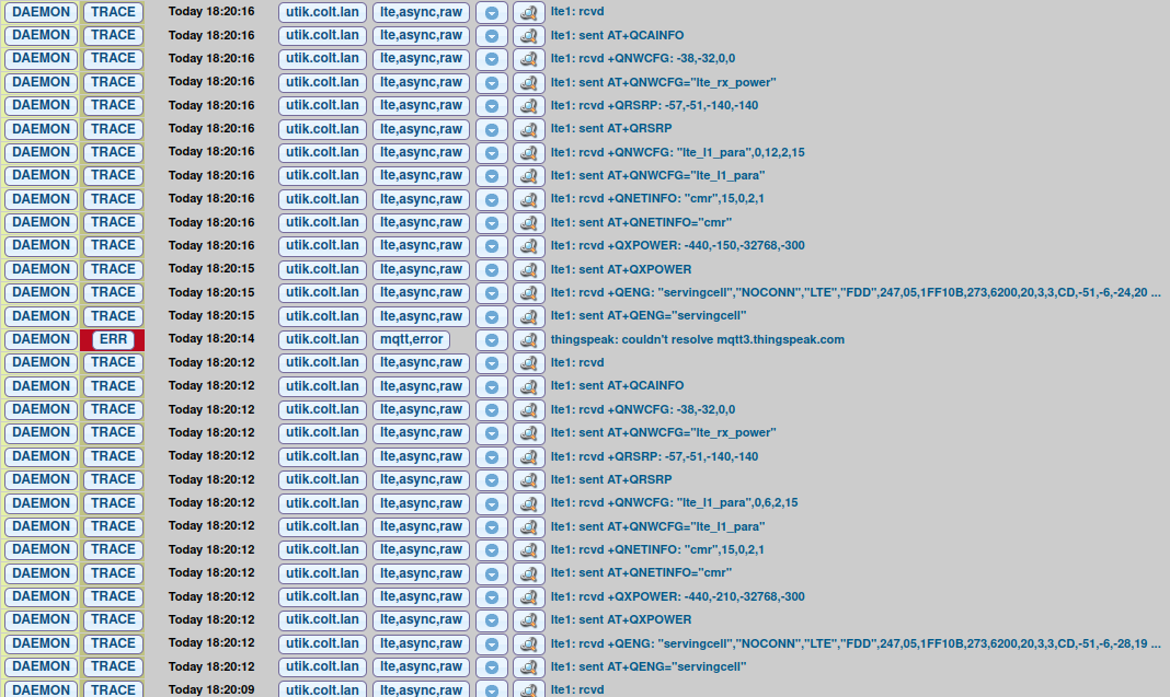

Well, i believe you are true and like i’ve previously mentioned it automatically recovers. But delay when it happens is not constant and may be up to 5 minutes (haven’t noticed more than that), which is not preferable for example for iptv. Router os build is 7.6 and lte modem has the latest firmware (http://forum.mikrotik.com/t/chateau-lte12-band-20-issues/163060/3). I’ve recently noticed this problem so haven’t checked everything (i.e. does it happen on other bands or not), but “lte,debug” logging isn’t helpful even with “packet”. After i’ve configured remote logging i’ll try to monitor this issue with “raw” enabled.
So, while a real cause of this problem is not clear i want to minimize network down time and that’s why i’m posting:
Logs right now capture only dns failures, but it can’t be a dns problem, because it happens not only with DOH, but with unsecure dns, too.
I haven’t yet managed to setup pinger to record ping results in logs, but if at that moment i manually run ping by ip mikrotik cli, for example 8.8.8.8, it’s unreachable (while watching iptv it’s easy to identify that moment).

For sure you’d want to make sure everything is upgraded to at least stable. And likely worth trying “testing” 7.7rcX too. But Mikrotik support is actually pretty good at looking at these LTE issue. Perhaps not quick. But they’d want similar to logging and supout.rif files (and that were running latest builds). Two supout.rif likely be more useful to them: from when it working and ideally one when it’s in the hung state. That’s why I was a little harsh on the script - it might help speed things recovery but someone else may run into same thing.

I totally understand your point, thank you. I’m a bit skeptical about support, because, like you said, it’s may be “not quick”, but everyone at home wants to watch TV without visible hangs at least most of the time. I suppose most of us at least once in a life was in a situation when someone demanded smth and refused to hear any excuses, moreover when person is an expert in other field not connected to specific issue (i.e. mobile networks).
Additionally, the modem is acting strangely on a selected band (please, check attached post in my previous message), so i suspect that both issues may be somehow related and that the real cause of this bug is carrier, not a device or its firmware. Another reason why i don’t bet that it’s a device/firmware bug is because it often happens per day on this band, but event duration most of the time is quite short. I think that this should be investigated in the first place, before contacting MIkrotik support. At least, because if it’s a band issue, then i think that at the first place i should contact the carrier service provider support…
