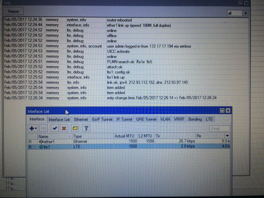

still have the same problem,
roll back to stable/last firmware, enable log to LTE (last 2 screens)
if have disconnected then search time is unlimited until restart rooter.
disable/enable lte interface also dont work.

Here is a log of events that occur more frequently than the higher the load:
lte1 link down
item removed
item removed
lte–: usb power reset
lte–: changing band failed
lte–: online
lte–: UICC PIN cmd result: SUCCESS retry count: 3
lte–: UICC activate
lte–: online
lte–: PLMN search ok xxx
lte–: attach ok
lte–: lte1: config ok
lte1 link up
link ok, ipv4: xxx, dns: xxx
lte–: link ok, ipv4: xxx, dns: xxx
item added
item added
