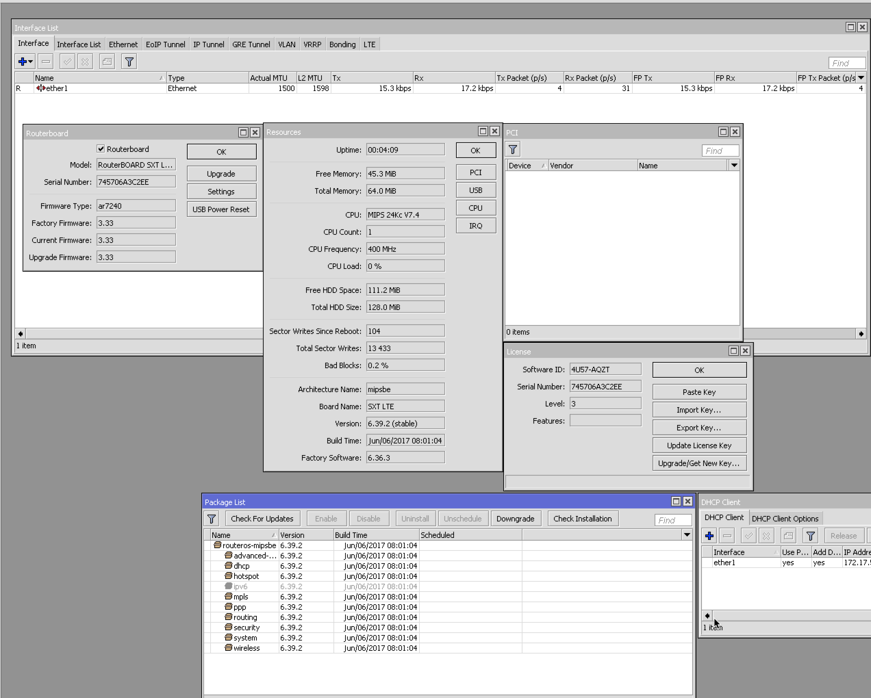

I have my SXT LTE to version 6.39.2.
Unfortunately he crashed.
Afterwards I have in with the netinstall reconstituted.
Unfortunately I am missing since the lte interface.
Have him already synonymous to the version 6.37.5 unfortunately without success.
Can someone help me?
Greetings from switzerland
please install a lte package and the lte interface will appear again.
Hi uldis
Thank you for your quick help.
To the lte packet I have not really thought.
I always assumed that for the standard things the pack is not needed.
Thank you
