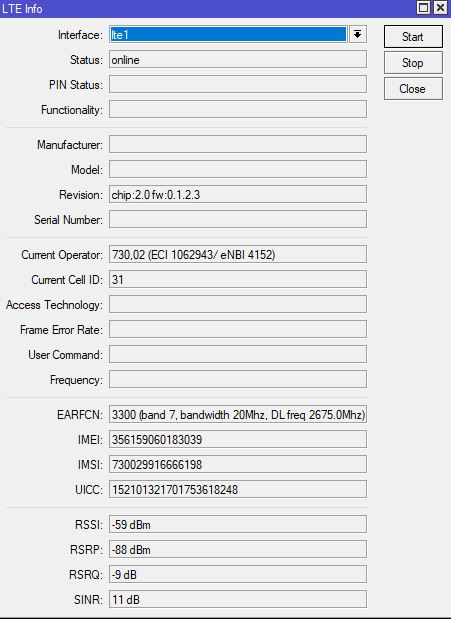

I installed a brand new SXT LTE. I am using it with Movistar in Chile, which works with 2600mhz Band 7.- I am getting full bars in the led lights outside the antenna, and getting around -88 to -90dbm signal power (SINR is around 15 and 20).-

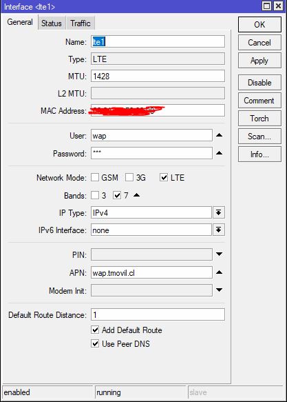

I am using the same APN in both devices. Signal in the Oneplus 3T is around -100db. Tried MTU 1500 and 1428 in the SXT.

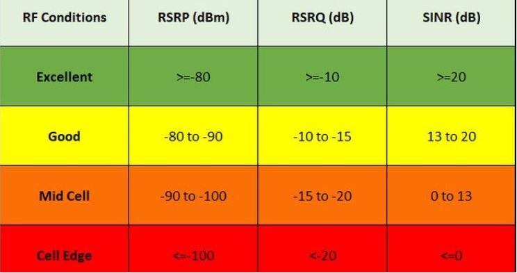

Also, what signal strenght should I be looking?

I uploaded some screenshots from my configuration.

Should I look for a value around RSRP (-80)dbm, or better?
