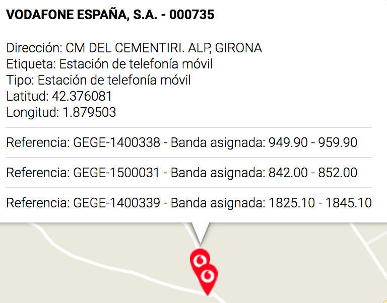

Which frequency is the tower running? The antenna works best for Band 3.
The tower is on Band 3. These are the tower details as per the official government database:
Is there any way to get more details about the scanning / PLMN search progress?
SXT LTE can connect only to Band3 (1.8ghz) and Band7 (2.6ghz). Probably your phones connected to Band20 (800mhz) which isn’t supported on the SXT LTE.
So while we have 800MHz LTE, in this case the Android phone and TP-Link are connected to Band 3. I have checked with Field Test on iOS and it is connected to an 800MHz tower.

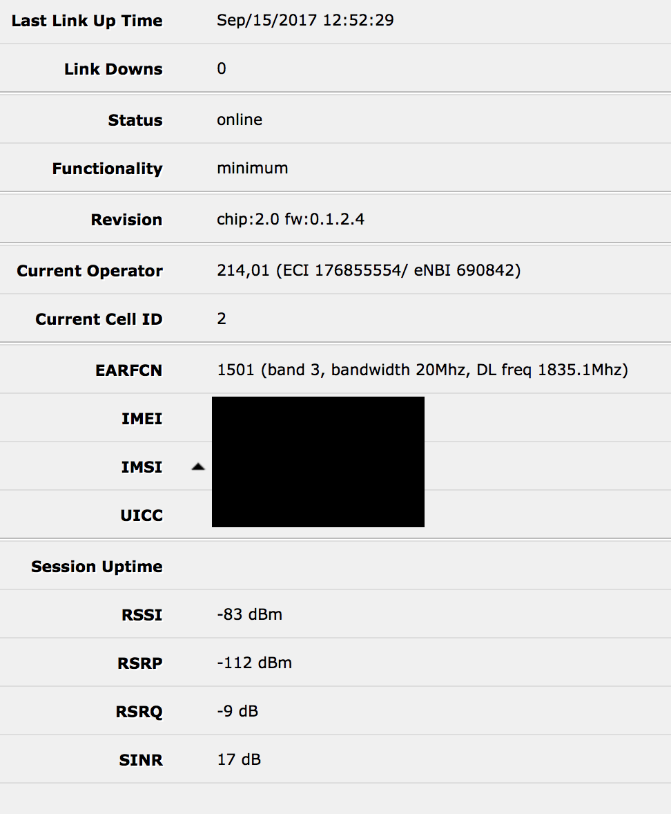

OK thanks, good to know. I have moved the antenna’s location, and it now establishes a link to the cell:
Download 28Mbps, upload 3.5Mbps. I’m on 6.40.3. It would be really really nice to have some real-time tools eg. scan working :slight_smile:
you can now adjust the antenna position and watch the signal values.
