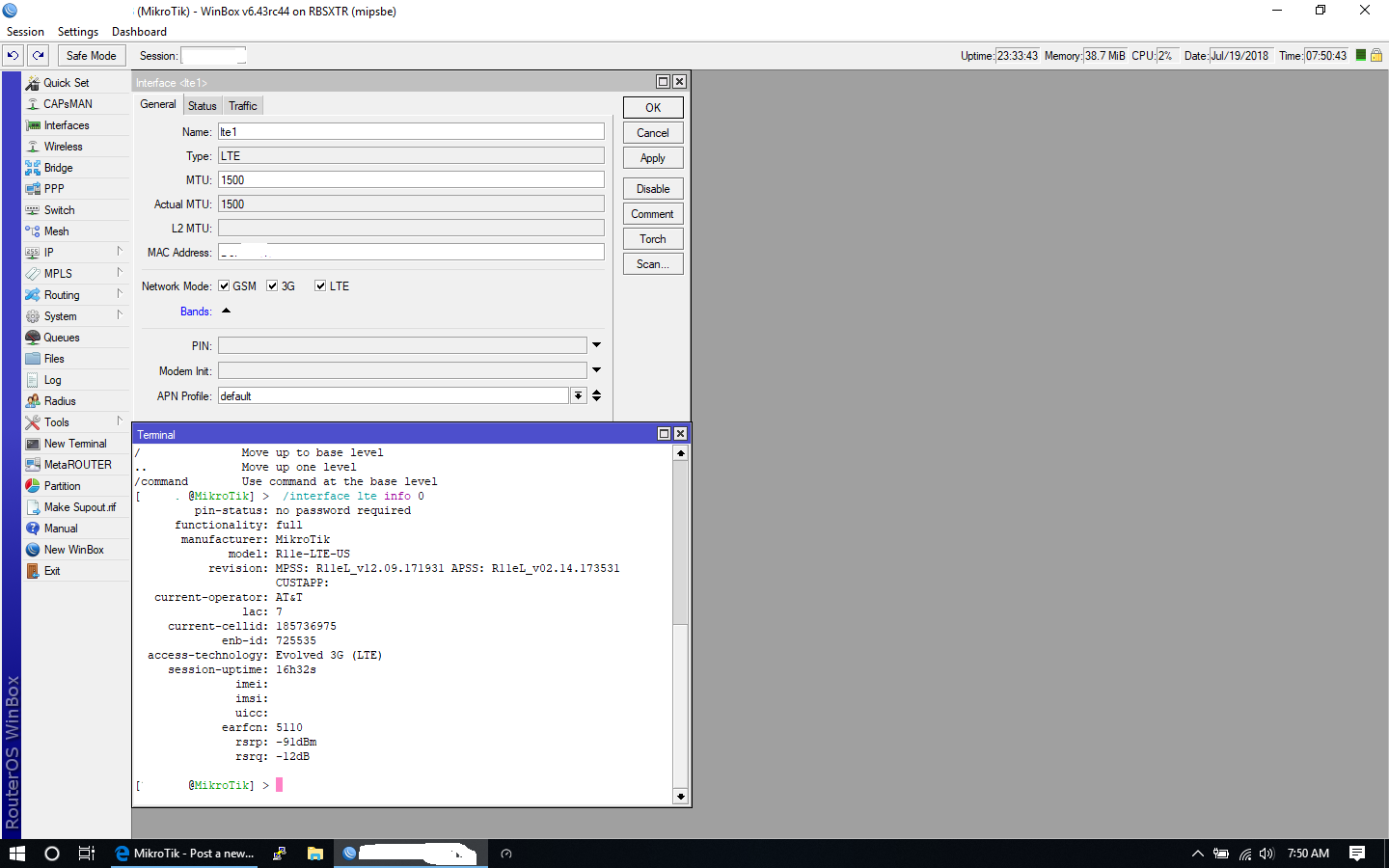

I was wondering if anyone can help me figure out what band the modem is using and how to change it?
When I click the down arrow the box disappears, also when I type /interface lte info 0 it does not show what band is currently being used.
Thank you for time, and help
David Huizenga
What gives you the channel information is the earfcn number. 5110 converts to 709 MHz (uplink) and 739 MHz (downlink). See e.g. this online calculator or this more up-to-date table.
Thank you for your fast reply, now how do I change the band to say band 2 to see if I can get better speed?David Huizenga
changing band for the R11e-LTE-US is not supported. It chooses automatically the LTE band. You can only disable the 3G mode and leave only LTE mode enabled.
Okay, thsnk you. Will there ever be a time we will be able to change bands? Ohh and one more thing how do i mark this topic as solved/closed?
Is there an at command or some other way around this? This is important to me since my radio is connecting to a high frequency band and it’s on the fringe, where 700 mhz band 12 is fine here. need to be able to set it.
