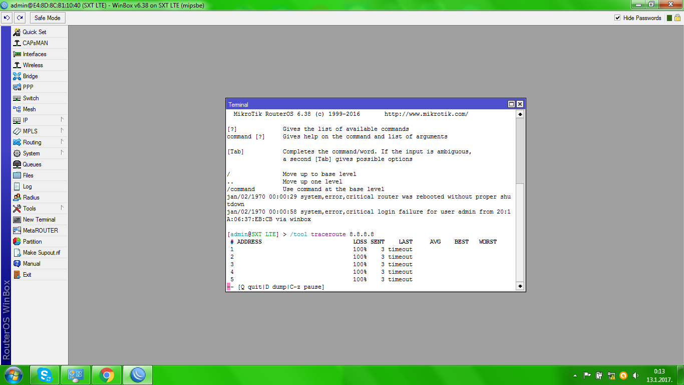

Open a terminal in winbox and type this:
/tool traceroute 8.8.8.8
Paste the results

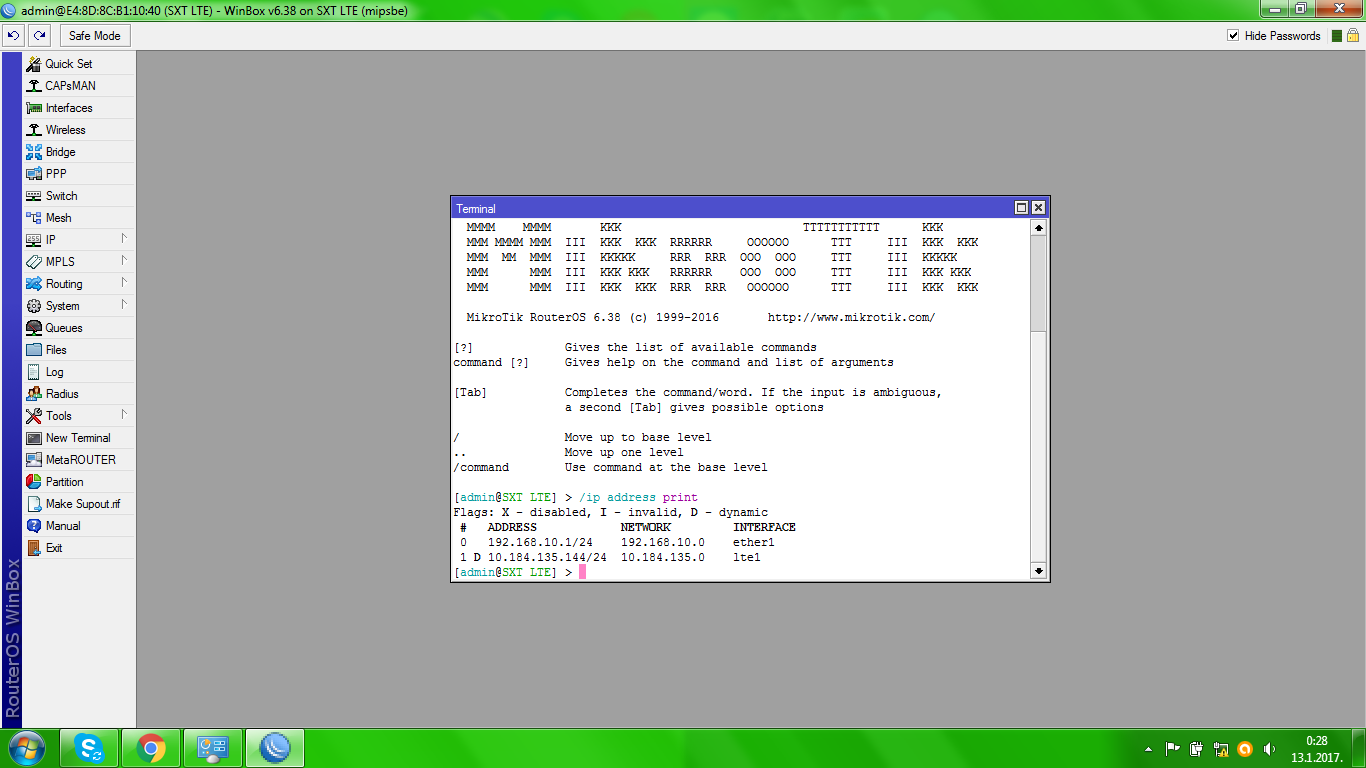

From the quickset screen it looked like you have, whats:
/ip address print
Say ?

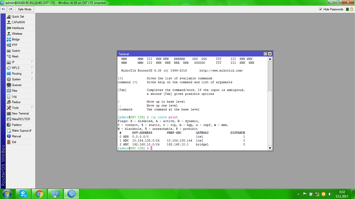

This
/ip route print
This
